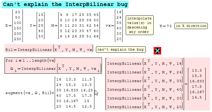

InterpBilinear Unexplained Bug
InterpBilinear Unexplained Bug - InterpBilinear Unexplained Bug - Сообщения
#1 Опубликовано: 05.07.2019 19:25:51
Bug InterpBilinear.sm (24,88 КиБ) скачан 1232 раз(а).
#2 Опубликовано: 06.07.2019 11:19:46
As I've stated in the other thread, there isn't a check on 4th and 5th arguments, that should be scalars.
The implementation is a 1:1 port of a code that was discussed here on the forum some time ago, not based on built-in linterp; here there is your example with the InterpBilinear function exposed in worksheet code (intBil).
InterpBilinear_debug.sm (21,64 КиБ) скачан 1227 раз(а).
Seems that a vector argument can fool my binary search function, that doesn't stop the wrong input and ends calculating wrong results.
P.S: I'll fix the plugin as soon as I can
