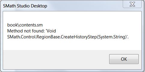

Where is it? I clicked on "Help" ..Reference Book and got an error message, which says Method not found. the forum software won't let me upload an image from my computer or I could show you a screenshot of the dialog box. Why wasn't the Reference Book included in the software I downloaded?

Try the portable distribution (see link in the signature). This has a lot of stuff pre-installed.

I downloaded the portable and unzipped it. I saw a "books" folder and looked in it and saw the sm files. That made me curious and I checked in my Program Files folder and it too had a folder labled "Books" and all the sm file were there too. why do I get that error?
#4 Опубликовано: 23.04.2014 03:48:30
Extensions (those downloaded via Extensions Manager) are stored in your %APPDATA%\SMath\Extensions directory
About the error, what version of SMath Studio are you using? I suggest you to use the latest Nightly build

Sorry for late answer.
Please, try to set default Reference Book in the Extension Manager as shown below:
