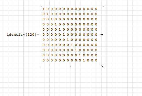

The content might be hidden if the matrix is too large (number of elements or width/height)
Check if there are ellipsis displayed on the left/bottom edges and drag them aroud to display the hidden content.
Otherwise as suggested above attach the file that doesn't work for you

Thanks for replies - it does show an ellipsis and dragging has uncovered the hidden column. Problem solved!
