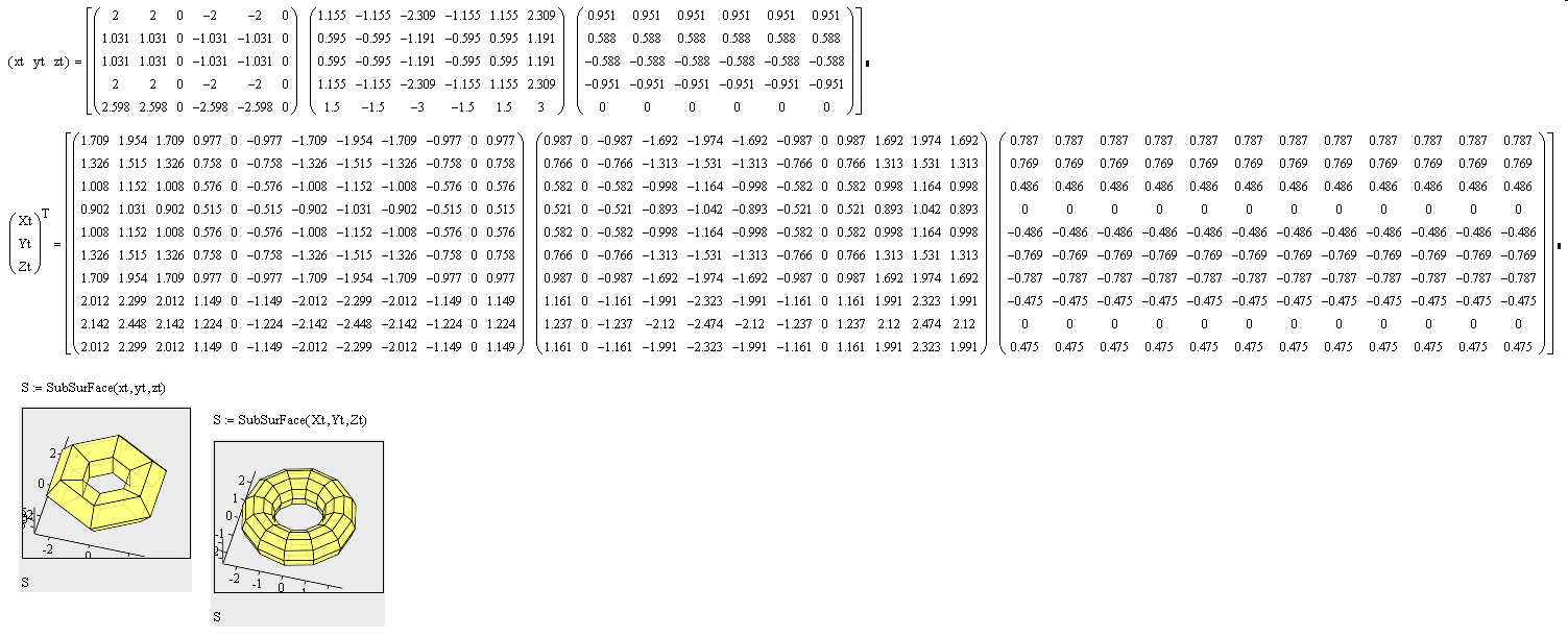

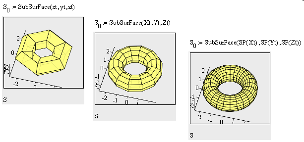

Presumably, I understand what you are after ...
... Create a 3D system of vertices, you need 3 matrices.
We have it in Mathcad from Russia. Even if it is possible
to code in Smath, no way to plot because Smath does not plot
stacked matrices [it does not plot matrices at all].
Smath plots matrices as image but not as 3D.
The Mathcad 11 program subdivides by 2 each step from
the Catmul-Clark B_Spline. On the other hand, Mathcad
is on ORIGIN [0], it adds difficulty to code Smath.
In short: I can attempt to code wrt Smath ORIGIN [1].
If your base 3D system does not plot 3 stacked matrices... zap !
Chers, Jean

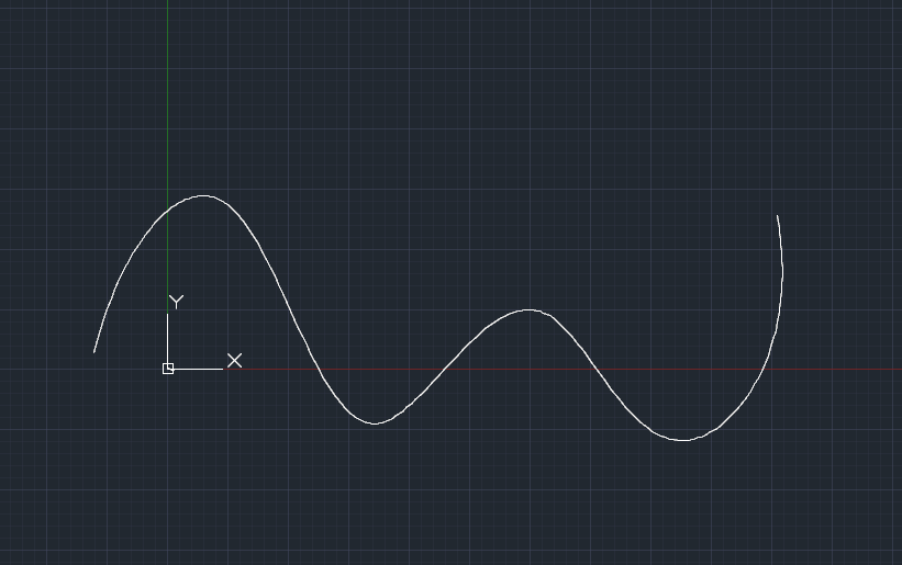

I looked at the example of Hermite's polyline, the resulting spline is not similar to the spline obtained in the CAD system. I send the superimposed spline of the CAD system to the graph of the Hermite polyline.
Bézier Cubic 4 cntrl points looks more like the desired spline.
Spline used in CAD systems non-uniform rational B-spline (NURBS).
I spread an animated gif from Wikipedia, it will explain very well how the spline is drawn in the CAD system and how it is edited.

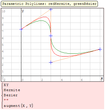

.WroteI looked at the example of Hermite's polyline, the resulting spline is not similar to the spline obtained in the CAD system. I send the superimposed spline of the CAD system to the graph of the Hermite polyline.
The CAD example [image] is probably Bézier parametric.
They just perform differently, especially if the end
points aren't duplicated. In other applications,
Hermite has much better smoothing properties than
DeBoor, Bézier .

We can not choose any other type of spline. Between the CAD systems should be a single approach to the construction and display of the spline. We are limited to the dxf specification:
https://www.autodesk.com/techpubs/autocad/acad2000/dxf/spline_dxf_06.htm
Here is another link to the presentation of splines. as I understand, the 38.40 page shows the NURBS spline and the text says about the meaning of roots and degree
https://www.cs.drexel.edu/~david/Classes/CS430/Lectures/L-09_BSplines_NURBS.pdf

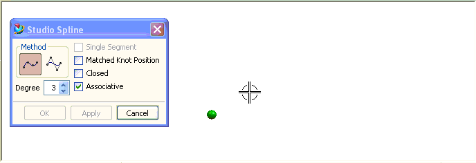

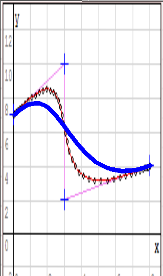

Hi!
Sorry that I did not answer for a long time, these days were very busy.
As part of our program, we can add many kinds of spline lines, but we need a spline that supports all the other KADs.
I studied the spline lines sent by you. below the picture. I also added the information that AutoCAD adds to the file for the correct display of the spline line description
black dashed line - this is because the points outside the spline line are located
pink - this is the spline line obtained by auto cadence
If you can't choose splines that work for Engineers, what's the point of the exercise.

... from what your system shows, I guess the spline is Bézier polyline.
This type of multipoint is executed from the DeCasteljau algorithm,
more numerically stable. We can't reproduce it scalar algo style Mathcad 8.
I may still have the Bézier polyline demo in what's left from Mathcad 11.
Will be back later on.
Cheers, Jean
Cheers, Jean
... that confirms your CAD system is Bézier-DeCasteljau.
