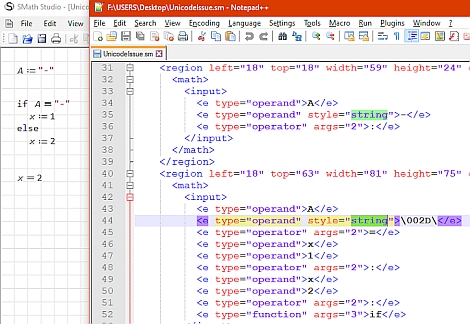

Without the file it can be the same as gambling. My best guess is that when copying and pasting text many times SMath takes the unicode character instead of the simpler ASCII character, as in the attached file.
UnicodeIssue.sm (2,68 КиБ) скачан 1458 раз(а).
Conclusion: do not copy and paste quoted strings in SMath, but rather write them.

2.) Copy the "-" from inside the matrix.
3.) Paste (replace) this into your functions.
