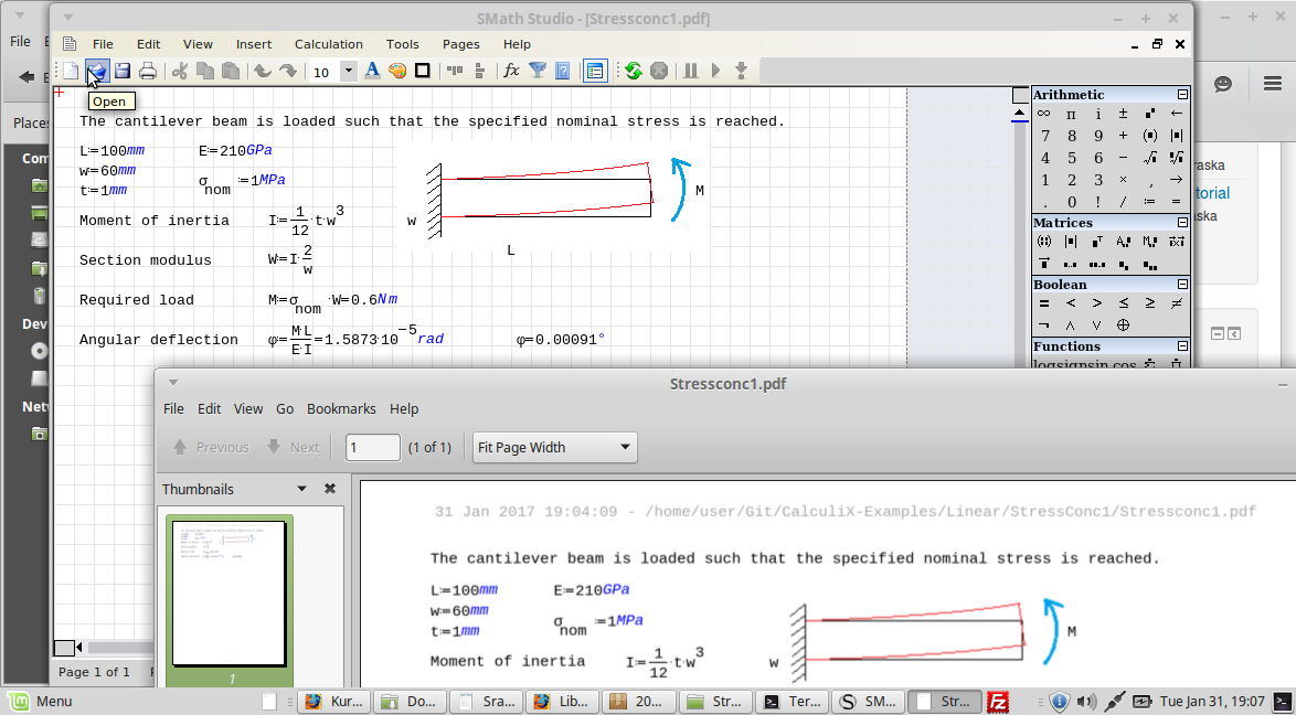

Did you try File> Save as> File format: PDF?
This works for me in a virtual linux box under Win 7
You need the pdf files plugin.
If you use the portable distribution (link in signature), many plugins are pre-installed (the maxima plugin, however, does not work under linux)

Actually, the VM runs ubuntu and SMath is executed with mono in the screenshot. The displayed pdf is generated by save as under linux. As I said, you need to install the pdffiles plugin by Andrey Ivashov.
I believe that this is not affected by whether linux is run on a virtual or physical machine.
BTW, this is also advisable unter windows, as it avoids the usual font size problems when printing directly (depending on dpi settings the region scaling is a bit unreliable.
