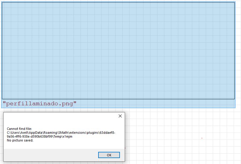

Hello guys,
I don't know what's going on, but my ImageRegion doesn't work. A blank image remains and when saved the following message appears:

This is because of correction related to special characters made in MathRegion in the last beta of SMath Studio.
It seems we need to update many plug-ins now.
Everywhere where text from Math Region is taken we need to use TermsConverter.DecodeText(text) first.
I've investigated it a bit and see that this error was always there but it was not so often visible because less chars was encoded earlier.

ImageRegion fixed now. Please update it using Extensions Manager.
Thank you so much Andrey! It´s works now

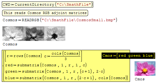

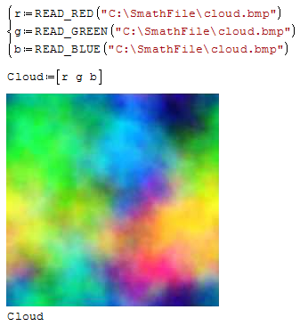

I don't know what's going on, but my Image Region doesn't work.
You can try earlier SS 6179 simpler way
i.e: assign the image as a plotable image argument.
#6 Опубликовано: 10.04.2021 10:11:12
CWD is not needed ...
