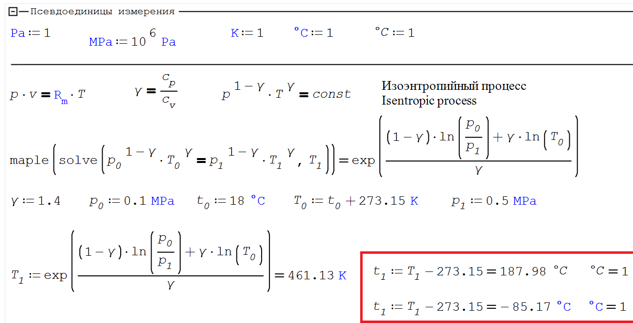

Re-defining units is actually calling for trouble. In the given case, re-defining °C does not switch off the conversion mechanism, which is triggered when displaying results in non-absolute temperature units (which does not happen when you use the non-unit custom constant °C). I would not call this a bug, because re-defining units is nothing which I would expect to be supported and consistently handled. One might call it a bug, that re-definition of units is possible at all (just as with the imaginary unit, which unfortunately is re-defined if a value is assigned to the variable i).

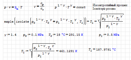

Hi. The result of solve is thinking that the variables can be complex. To obtain a more concrete result, you can use isolate. And this allows the more comfortable use of the units, without the need to "sterilize" them (Pompelmo dixit)

Note: For me, the convention that uppercase letters represent intensive variables and lowercase letters extensive variables is very practical. Thus, temperature and pressure always appear in capital letters, and volume, enthalpy, entropy and energy can be upper or lower case. The units, if intensive, will say whether they are volumetric, mass or molar quantities.

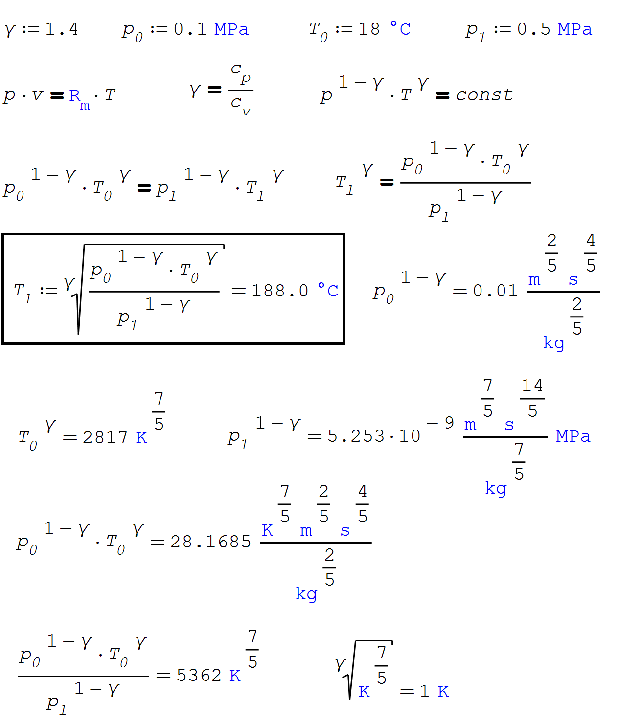

I'm completely lazy - I'm solving the simplest equation on the computer, not in my head!
