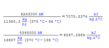

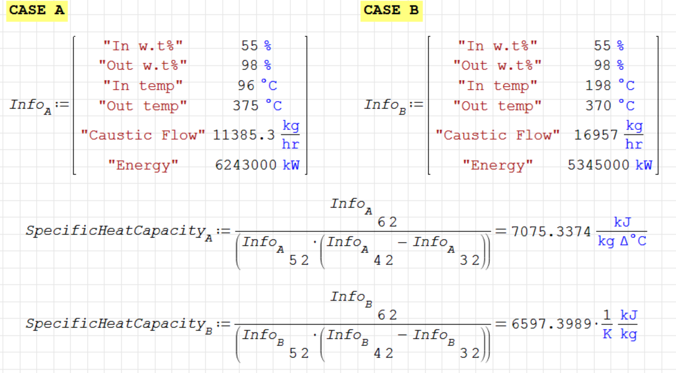

I am having problem while evaluating specific heat capacity from given data while invoking unit calculation as well

Radovan, I do not think is correct your indication (Wrong/Right) as it is a temperature range you must use ' Δ °C.
Using the Kelvin grades instead this differentiation is not necessary (in fact in the Smath standard there is no ' Δ K).
Hello Sergio,
This was mentioned many times and I just wanted to point out that if you have something in ' °C you have to add or subtract in ' Δ °C (and not in ' °C) to get the result in ' °C.
I agree with you. The simplest thing is just to use ' Δ °C only when the temperature difference is the case.
I should have mentioned this as well.
#6 Опубликовано: 05.09.2018 09:29:50
I agree that the first line is wrong regardless what you actually want to express.
  • If the two operands are really meant to be temperature points then the result is a change or difference of temperatures and it's unit must be left to K or set to Delta°C. Setting it to °C is wrong.
  • If the second operand actually is meant to be a temperature difference or change, then it must have the unit K or Delta°C.
The second line can be right or wrong, depending on your actual intent.
  • If the first operand is a meant to be a temperature point and second operand is meant to be a temperature difference or change, then the result is a temperature point and the unit can be K or °C. Nothing wrong then.
  • Surely, if the equation is meant to represent something different, then it would be wrong. But that can be said of any equation in any document.
If everything is meant to be temperature differences, then this one is correct:

In my opinion, the correct writing is as follows:
Smath does not do it independently (because it returns the result in ' K) and then if you want to act manually on the unit of measure ' Δ ° C
I would add that, indeed, for those who have not followed the numerous interventions on the forum, it is difficult to operate correctly.

The right way is @ post 4,
i.e: put unit on the maths, not on individuals
Correct as well ...which brings us to the first post. If the question missed the point, the answer will be as well. Actually, it seems there was all right with the picture. We had many correct answers ... but, what was the question actually ???
#10 Опубликовано: 05.09.2018 20:08:45
Quite right: wrong question may be implicit of wrong answer !
Assume you have a differential meter, it performs [a-b]and you put
the unit you wish ... per say => answer= $
SI temperature unit is K ... thus post 4 is correct two ways.

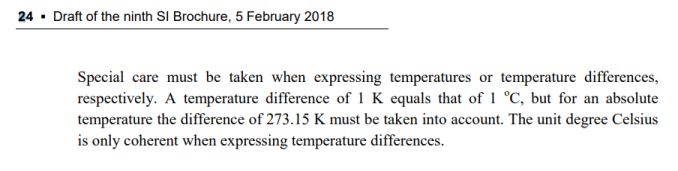

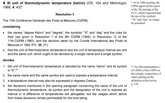

Hi. It's an old resolution, but figures in the last version: https://www.bipm.org/utils/common/pdf/si_brochure_8.pdf
The last proposed revisions warm about the temperature differences, but claim for the use of ºC (https://www.bipm.org/utils/en/pdf/si-revised-brochure/Draft-SI-Brochure-2018.pdf):
So, I don't see the place of the Delta Celsius.
