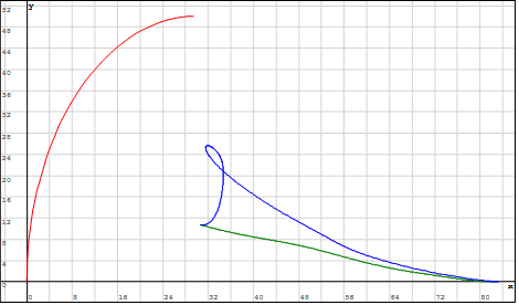

Hello to all.
I have traced these three functions, that depend on time, on the graph.

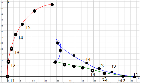

How can I insert numbered points, superimposed on the traced functions, so that the same numbering corresponds to the same instant of time?
To be clear, I should do something like the following figure …
This is the .sm file: CALCOLI TESI manovra.sm (69,86 КиБ) скачан 1111 раз(а).
thanks in advance for the help

using some good tips posted by Jean, you could do this:
CALCOLITESImanovra_s.sm (78,32 КиБ) скачан 1115 раз(а).
I preferred to refer to actual times and not to anonymous labels; however you can use the same methodology more easily
Easy ... take the DE that I doctored before
there may be some sanity wrt the other two graphs.
