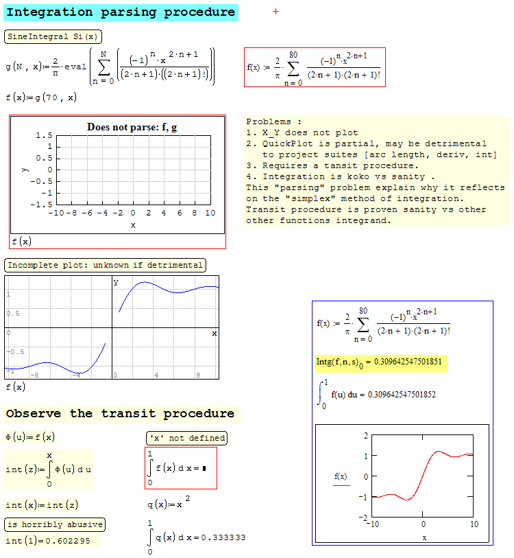

That one is for Designers wrt the latest Nightly build.
Done in Smath 5346 OFFicial release.
jean
Maths Integration Parsing Procedure.sm (23,92 КиБ) скачан 1279 раз(а).

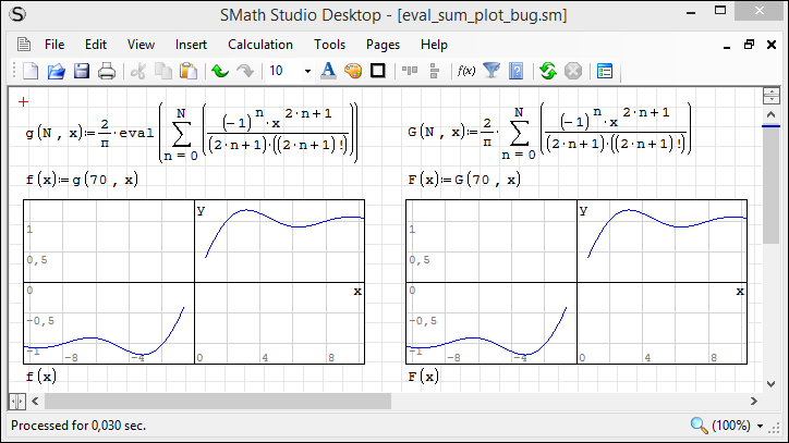

Jean,
Thank you! Fixed. And... if previous versions of SMath Studio required eval() function to be used, now it doesn't matter anymore.
eval_sum_plot_bug.sm (7,14 КиБ) скачан 1294 раз(а).
