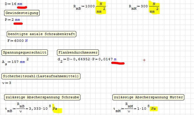

i have a lot of problems with units
if i want mm the program makes m
if i want N/mm2 the program makes Pa
is it possible to defin it ?
how do you do it ?

Units in results are by default in base units. You can set the more appropriate units for the single result writing in the rightmost placeholder (wiki: units)
If you are interested to have default output units you can register in the Bug Tracker System and vote SS-1
