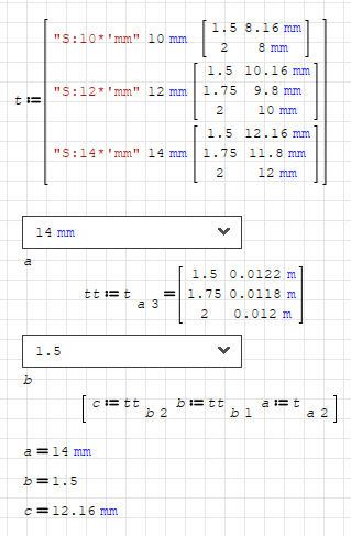

You may need a temp data derived from first combobox selection.
And use that new data at second combobox.
Here is your both questions answered.
combobox_question.sm (8,36 КиБ) скачан 1242 раз(а).

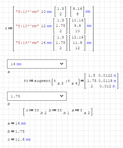

#3 Опубликовано: 17.07.2022 17:28:21
You can reduce data matrix like this too.
combobox_question.sm (8,29 КиБ) скачан 1285 раз(а).
Exactly what is needed. Thank you!
