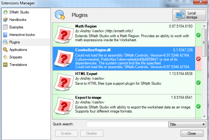

I have been using SMath for a while now, but have not tried any new plugins.
Today I tried to install the ComboBoxRegion, but it would not install. I now get an error message when the program loads. "Could not load file or assembly 'SMath.Controls, Version=0.97.5346.42164 ... The system cannot find the file specified."
I also downloaded the .zip file and placed the .dll files in the plugins folder. that did not appear to make it work either.
What might I be doing wrong that this does not load?
I also would like to know how to remove it from the list of Local storage plugins?

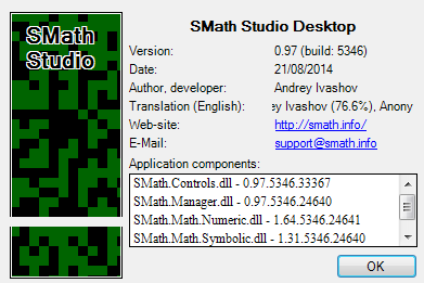

Hello E-Jay, what version of SMath Studio version are you using?

Version: 0.97 (build: 5154)
Date: 2/10/2014
