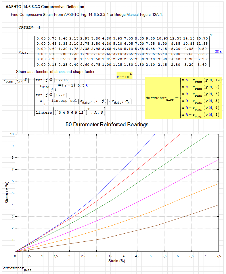

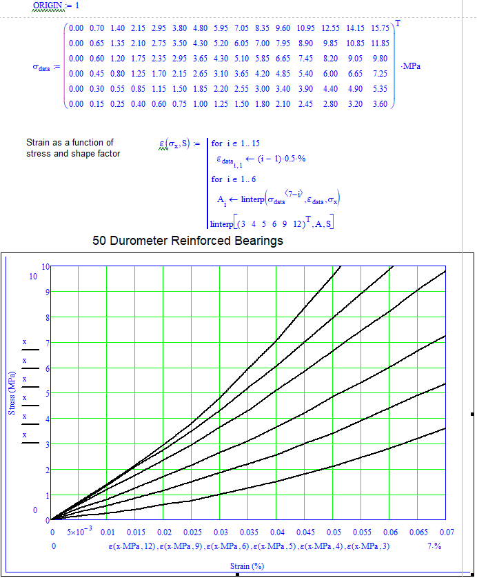

Question: Below is a screenshot of a 2D plot I can pull off in Mathcad. Does Smath studio have the ability to do similar? I was looking in the wiki and other examples, it seems as if they might be an option, but I can't find anything for defining X-Y plot limits. I think I can pull off the multiple lines with the System of Values smath command, and get each of those durometer lines at 12, 9, 6, 5, 4, and 3. But I am struggling with getting it to plot anything at all.
Mathcad:

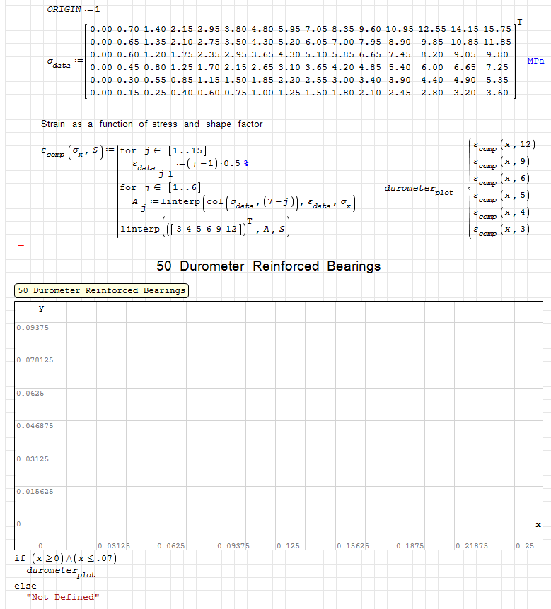

What I have in Smath so far:
FYI, I use Sigma.comp in several places in the worksheet, and it returns expected values. So that definition and the linear interpolation is functioning properly. Thoughts?
Mathcad:

Try X-Y Plot Region and attach the document.
WroteTry X-Y Plot Region and attach the document.
Yes because in that one you seem missing, the boat.

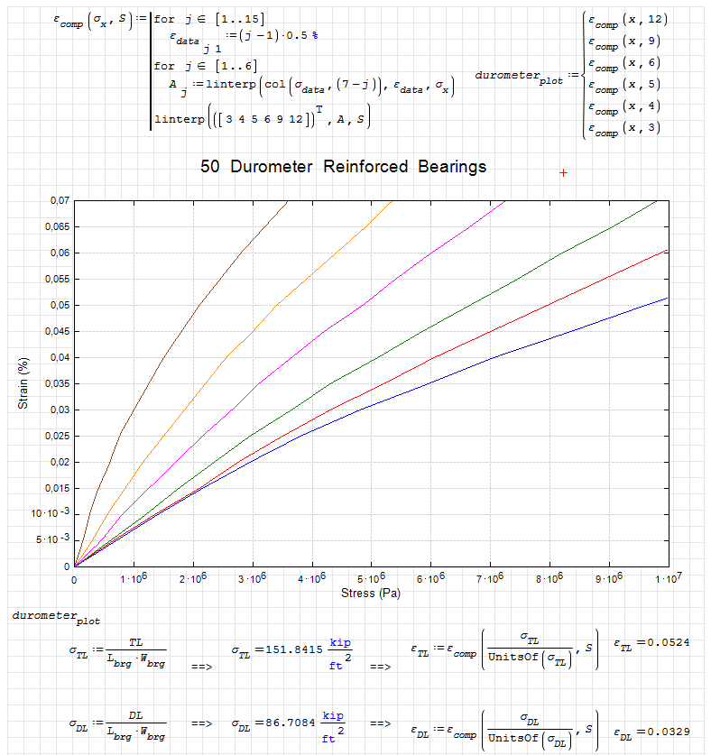

Thanks...I did not have X-Y Plot region addon. With it - I was able to get an output:
Does all that I need it to do. Only other option - see how MathCAD allows inverting access, or call Y-Axis range into equation. So I reversed position as X-Y Plot only seems to pull input from X-Axis. Is there a way to call Y-Axis?
If you attach the document I'll try to show how to invert axes.

Like this. Implicit plot mode used.
USC EB EXP LFD (uni).sm (130,45 КиБ) скачан 1209 раз(а).

Thanks Jean / Viacheslav...from examples provided, how the X-Y Plot Plugin uses the arguments makes more sense. Simple test - My_Function: x-y^2 yields a simple parabola. It just plots whatever equation of a line is provided. High School math, simple but effective! Much more intuitive than how Mathcad does it (in my humble opinion). So used to doing it the Mathcad way, I am not seeing the obvious sometimes in Smath.
