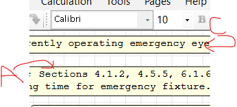

I'm assuming that the document mode is accessed via the button on the lower right next to the zoom spyglass. When I hover over it, Windows 10 as I never got the fonts fixed in Linux, it blinks like crazy and it's hard to select.
In addition, I ran into an issue trying to upsave some old files. I updated the font to Calibri and now the text in the descriptions do not match. New variables are using calibri and old variables that I carried over are still in Ariel

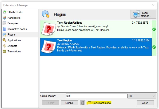

to activate the 'document' mode follow the instructions contained in the first post of this discussion.

Here is an instruction about how one can make Document mode enabled:
  1. Open Tools > Plugins..., find and select Text Region, set Document mode checkbox checked:
It was decided to show all descriptions using monospace font with no regards to what font is set as default for the document. This was implemented few Months ago.
Is it possible to make the descriptions and the "Area" descriptors uniform? Monospace font is fine, consistency would be appreciated. Calculations look due to different text fonts. INTERPOLATION is a new area.

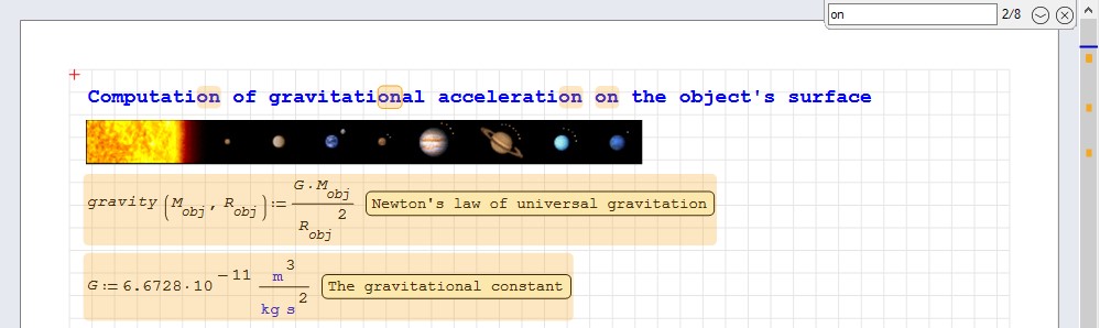

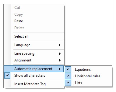

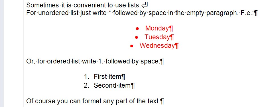

Important improvements in todays update: https://en.smath.com/forum/yaf_postst20114_Beta--SMath-Studio-0-99-7691--21-January-2021.aspx
Search in text significantly improved:

Automatic replacement can be disabled:
+ work with ordered/unordered lists significantly improved.
