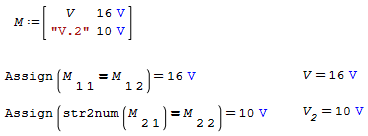

Is there a function or method that would allow a string (or variable name) located in a matrix element to be used as the name to define a variable?
Something like this:
Thank you!
You can also use the Assign() function of the Maxima Plugin (this should work even without Maxima installed).
It converts boolean equations into assignments.
In the case of strings you still need to apply str2num()
Assign.sm (4,75 КиБ) скачан 1334 раз(а).

Some odd behavior here. When the "=" evaluation is removed the Assign() function breaks:
Assign odd behaviour.sm (3,14 КиБ) скачан 1311 раз(а).
Any thoughts?
I'm hoping to be able to assign multiple variables from a matrix like this:
Assign For Loop Broken.sm (5,11 КиБ) скачан 1263 раз(а).

a small workaround, could be to place the for inside a line command and return a false token value, it is not very clean but it works as far as I can see.
I think the assign command is not evaluated immediately, but has a delayed evaluation, which somehow only takes place after using the "=" symbol.

Two hints:
- The Assign function needs to be executed in order to do it's work, either by assigning the result to some dummy variable or by requesting display of the result.
- You don't need a loop, Assign() can handle vector arguments
Blatt10.sm (5,31 КиБ) скачан 1344 раз(а).

Hi. This could be another option.
MyAssign 2.sm (10,52 КиБ) скачан 1333 раз(а).
