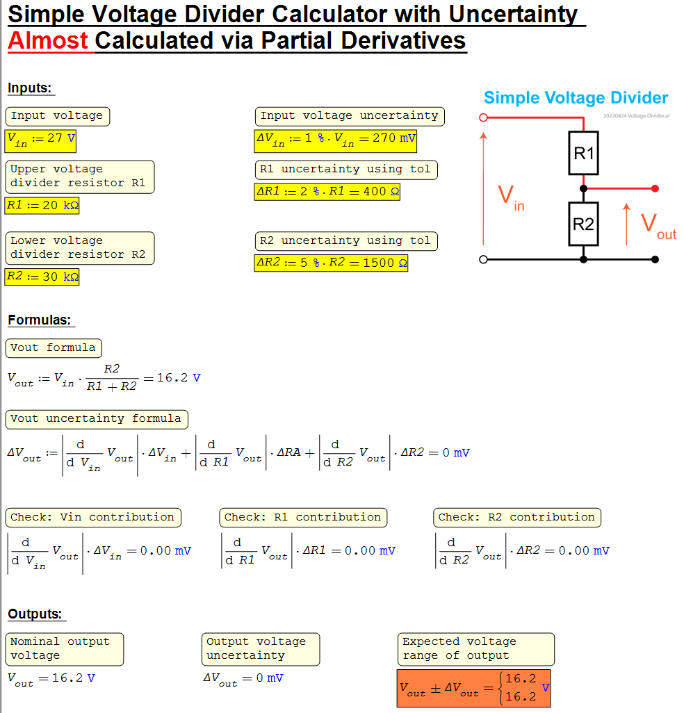

I've been diving into partial derivatives, but I think I am making a basic tool-use error as the calculated derivative contributions are all zero:
20220424 Simple Voltage Divider with Tolerances A3.sm (56,75 КиБ) скачан 1362 раз(а).
Thank you in advance.
#2 Опубликовано: 24.04.2022 03:29:47
Hi. The quick solution: Put the definition of V.out before the values definitions (and change DRA by DR1).
The technical solution: Use V.out(V.in,R1,R2) instead V.out. The only problem is that this way the expression for calculating the error is very long, visually.
The intermediate solution: unassign the variable "inside" the definition of V.out.
The main reason: like in mathcad, in smath the numerical derivation does not follow the usual rules of evaluation and does what is "Hold" in wolfram mathematica and "uneval" in maple.
Mark R Harris 24.04.2022 04:19:00

Thank you Alvaro, that is fantastic.
I shall dig in and learn about the automated summations.
A good reminder too: it is uncertainty being calculated (not variance). Fixed above.

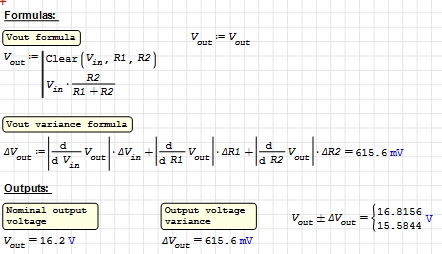

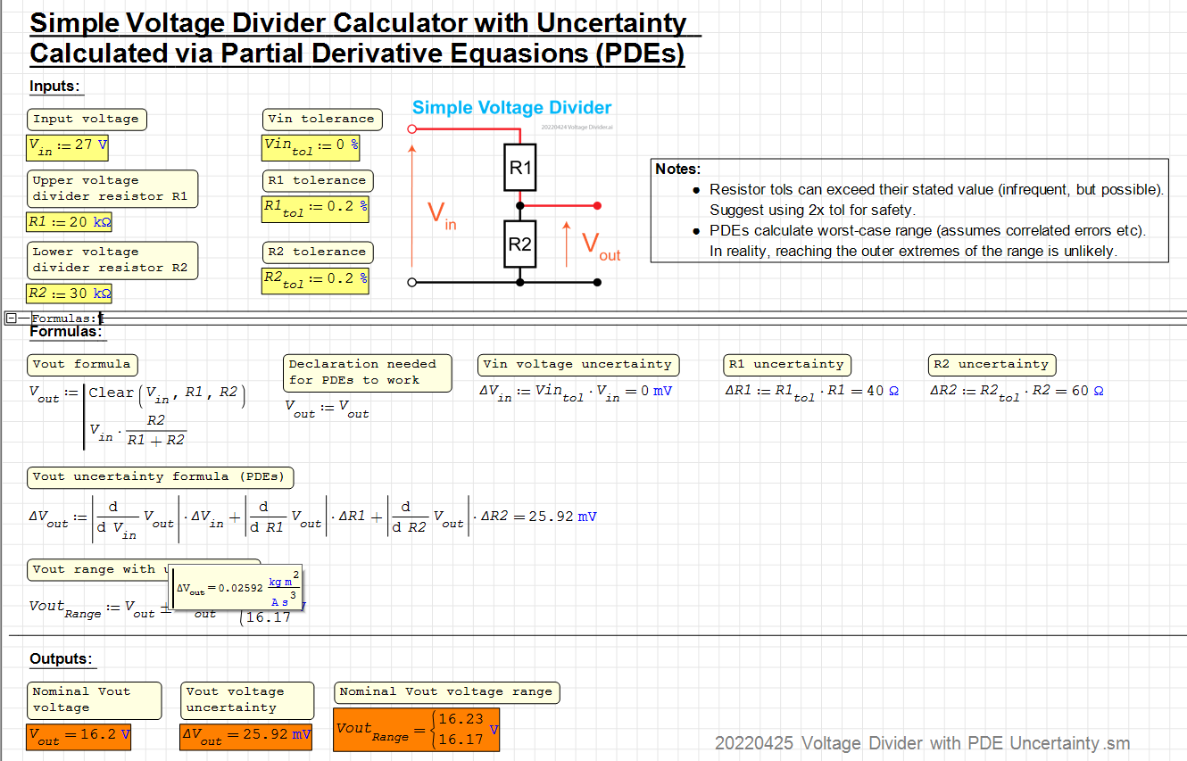

Thank you for your help everybody. Here it is working:
20220425 Voltage Divider with PDE Uncertainty.sm (59,27 КиБ) скачан 1396 раз(а).
