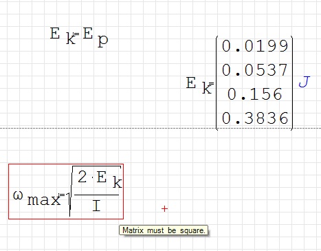

I get the following error: "Matrix must be square" when taking the SQRT of a single column Matrix.
Is there some way to do this calculation?

One of the ways
Ek.sm (4 КиБ) скачан 1454 раз(а).
#3 Опубликовано: 17.02.2013 06:40:09
You may consider using lists (AKA "systems" ). If the input values are obtained as matrix, then the function sys2mat from the CustomFunctions
Plugin may help.

Thank you, that works!
