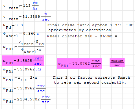

I am thinking about the engineering of train Cardin shafts and was having trouble getting my head around the way SMath worked with Rev/sec, Hz, rad/sec etc.
From an engineering perspective SMath treats these incorectly and thus returns an incorrect result. I can't find another explanation for this outcome so I have added a 2pi fudge factor.
From where I stand the pink statements are incorrect (and I'm not real big on the fudge factor).
Please help, are there options other than the 2pi fudge factor?
Thanks
Cya
Gus
#8 Опубликовано: 02.01.2018 08:31:45
You mix angular velocity (angle per time) with frequency (events like full revolutions per time). Your formula gives full revolutions per time, which isn't consistent with the symbol omega (which at least in Germany indicates an angular velocity).
If you want to switch from frequency to angular velocity you shouldn't use the same symbol and yes, you need your factor 2 pi.
My recommendation: always stick to angular velocity, divide your speed by the radius instead by the perimeter length of the wheel and use the unit rev whenever revolutions are to be indicated.
Thank you for your help.
I have implemented your suggestions in my work. A much more elegant solution than my fudge factor.
You are not wrong in anything you say, but I can't help wondering if there are not alternative ways for SMath to deal with Hz, Cycles/time rad/time & rev/time.
From a practical engineer's perspective (one that rarely does much math) rev/sec relate to cycles/sec or Hz more comfortably than than rad/sec. However, you have to piss with the dick you have; it is what it is (a great program) & infinite value when divided by price. I love it. 20 years ago I was a MathCad user.
Thanks again for your help.

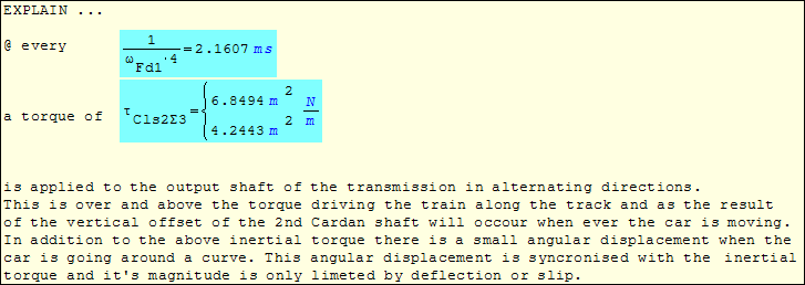

I've put together these calcs that anaise the vibrations in a transmission support fram that I have a
Cardin Shaft FD1 -Trans 180125.sm (861,77 КиБ) скачан 1725 раз(а).

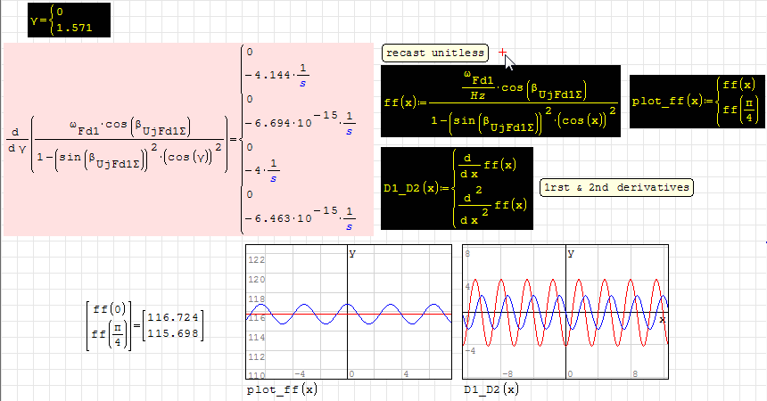

I have only doctored the 1rst & 2nd derivatives plots.
Cardin Shaft FD1 -Trans 180125.sm (878,26 КиБ) скачан 1664 раз(а).
Smath does not have the option to insert math region in text region.
You can still publish nicely, otherwise.
In the attached [2], the "Formated label" is incorrect vs Smath 6179.
The word EXPLAIN should replace the image RGBY square, as title
Cardin Shaft FD1 -Trans 180125[2].sm (883,49 КиБ) скачан 1510 раз(а).

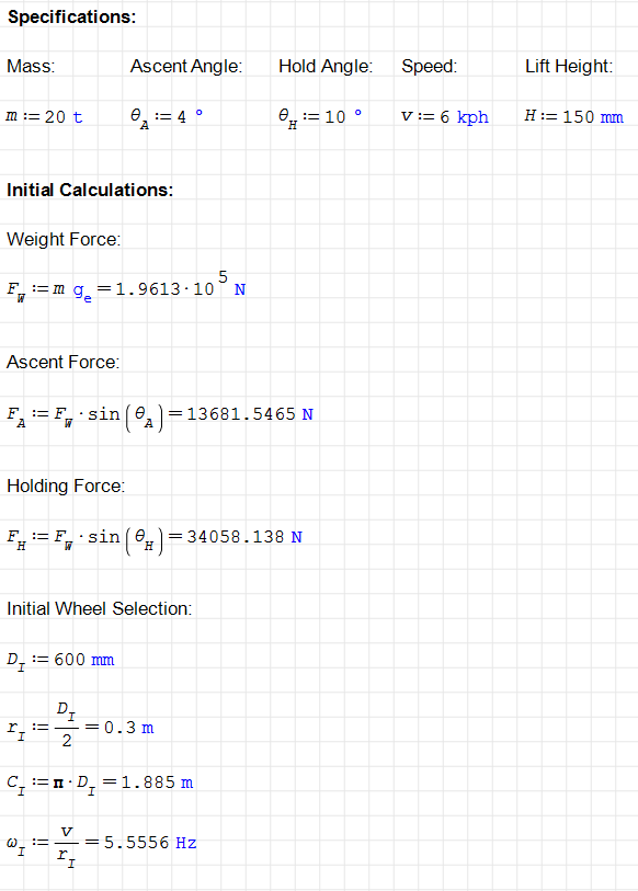

Ok, I have read a little bit on this thread, but I am still very confused. SMath is showing me that rad/s and Hz are equivalent. I would like to be able to calculate angular velocity as w=v/r and setting the units to rad/s. I understand that they are dimensionaly the same, but surely the rad/s to Hz conversion should include the 2pi factor?
#16 Опубликовано: 29.07.2025 09:48:34
Jago
Jago
my full working so far for referance so you can see where it has tripped up (the last line).
