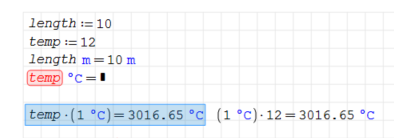

An image to describe the problem:

#2 Опубликовано: 17.09.2021 12:10:44
Ruben Sidranski
Ruben Sidranski
I can confirm. In addition, parenthesis and isolating the unit causes an error

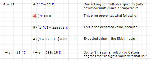

#3 Опубликовано: 17.09.2021 15:39:43
1 107 сообщений из 1 786 понравились пользователям.
Hi. I'm not sure if that error is a bug or a feature. Because it prevent an unusual task: using degrees scale temperature (those that have an offset) in a multiplication, where the usual is using the "new" Delta scale temperatures. I take my time to understand why it's neccesary to use Delta's, but get convinced after some good Martin's explanations (here).
This image shows why I think that:
Oscar Campo 17.09.2021 15:56:00, sergio 17.09.2021 16:15:00
#4 Опубликовано: 17.09.2021 17:30:10
Arie
Arie
I agree with Alvaro. The result is actually correct. I do believe it's still a bug, however, as you can add/subtract degC with seemingly strange, but correct, results.
