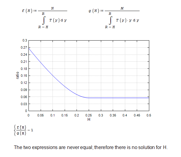

Generally, it does not like equal guesses.
if Units don't match, select all, 'ignore Units'
evaluate your eq vector with some tentative B,H
to be close to N,M ... I guess You did.
There are no roots!
