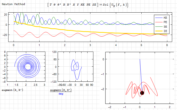

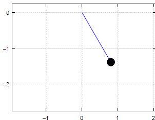

Why I have an error (???) in the sum energy?
Pendulum-PE-KE-SE.sm (71,29 КиБ) скачан 762 раз(а).
Отредактировано 01.11.2025 03:15:46

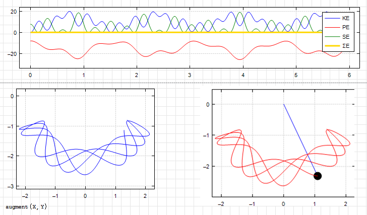

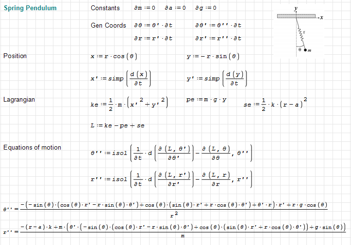

Hi. With a spring pendulum you have 2 degrees of freedom, thus you need two generalized coords. Using this post: https://smath.com/en-US/forum/topic/AeeMSM/Using-differentials:
Spring_Pendulum_lagrangian.sm (120,05 КиБ) скачан 767 раз(а).

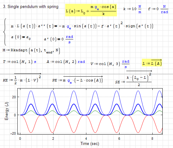

#3 Опубликовано: 01.11.2025 07:22:14
Valery Ochkov
Valery Ochkov
66 сообщений из 684 понравились пользователям.
Is it not correct?
We have 2 degrees of freedom, but can use only one!
Pend-1-Hook.sm (16,68 КиБ) скачан 726 раз(а).
Отредактировано 01.11.2025 08:38:01
#4 Опубликовано: 01.11.2025 08:39:40
1 111 сообщений из 1 787 понравились пользователям.
Is it not correct?

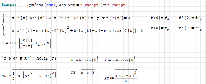

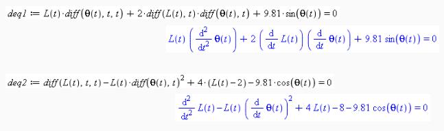

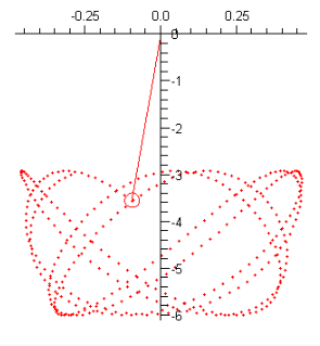

It isn't. You can not determine the variable length only with the angle. You need another differential equation for the length. For example, see https://www.maplesoft.com/applications/Preview.aspx?id=4897
with this result:
The Viacheslav's ode solver It can't handle those types of equations with that degree of coupling yet. For that, you should use the dsol I created, which should be somewhere in the forum, or use al_nleqsolve within the D function as in the other examples, or some other technique for decoupling the system.
In this case, the Lagrangian is uncoupled, so it can be solved directly.
Also, remember that the total energy is the Hamiltonian, so this is probably the correct method for solving problems when the Lagrangian is coupled.
Valery Ochkov 01.11.2025 10:47:16

Hi. Using the RKA file ( https://smath.com/en-US/files/Download/dZeevW/RKA.sm ) from https://smath.com/en-US/forum/topic/QWpkkQ/Mathcad-Toolbox both methods (Newton and Lagrange) for the spring pendulum. The code in RKA is, like the other one, just only in SMath, this is, it does not use maple nor maxima.
Spring_Pendulum_lagrangian.pdf (395,32 КиБ) скачан 422 раз(а).
Spring_Pendulum_lagrangian.sm (271,1 КиБ) скачан 807 раз(а).
Отредактировано 01.11.2025 19:21:12

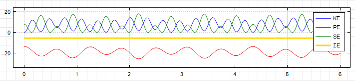

#8 Опубликовано: 02.11.2025 02:49:34
Hi. Friction added, Newton and Lagrange parametrized methods.
Spring_Pendulum_with_friction.sm (275,88 КиБ) скачан 797 раз(а).
sergio 02.11.2025 16:40:15
