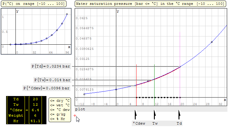

#1 Опубликовано: 09.04.2018 21:49:03
... refreshed for publishing.
Inst_Psychrometry [Weather Station].sm (221,12 КиБ) скачан 1124 раз(а).
