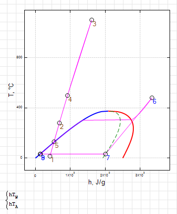

Hi. With T-s diagram.
Gas-Steam Ideal.sm (101,24 КиБ) скачан 1650 раз(а).
Gas-Steam Ideal.pdf (406,25 КиБ) скачан 1022 раз(а).

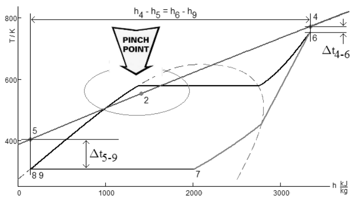

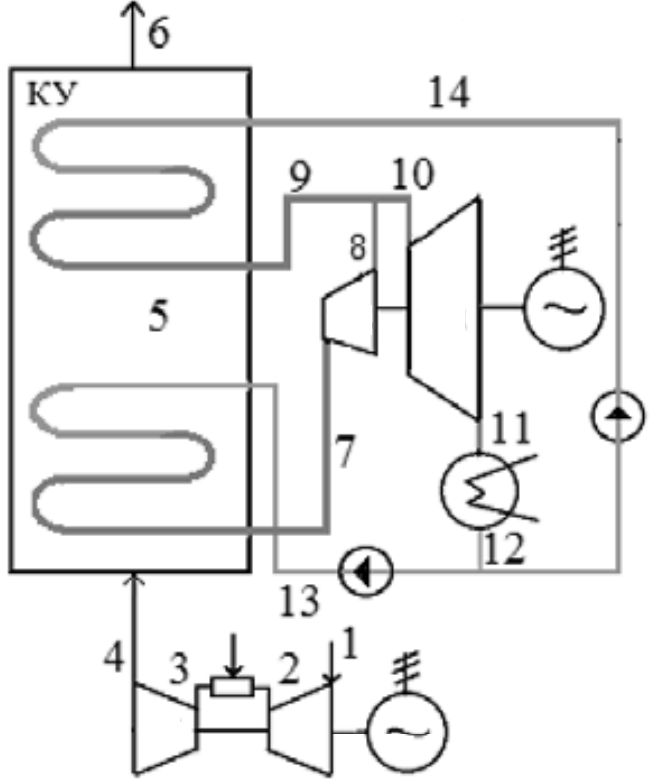

But see please
https://www.maplesoft.com/applications/Preview.aspx?id=154050
and this picture
Our cycle is not real in this sing. We must work with 2-stage unit

You don't have recoverable heat at state 2, it is on the compressed liquid region (even 2 are exhaust pipe, but I don't know how to catch the exergy into a reheater or new boiler in that case).
... Our cycle is not real in this sing. We must work with 2-stage unit
You need to guess some efficiencies or give some state for the reheat components.
This have the Ts, Th and hs diagrams.
Gas-Steam Ideal.sm (134,26 КиБ) скачан 1638 раз(а).
