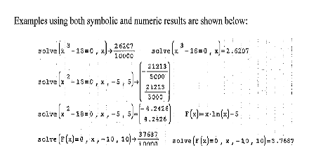

I am reading the manual. I am going through page by page. In the below, I understood everything before this point, but I cannot type what the example says:example.png
what comes out, no matter what I type is solve(x-1):=. I can't figure our how to put anything else in the parentheses.

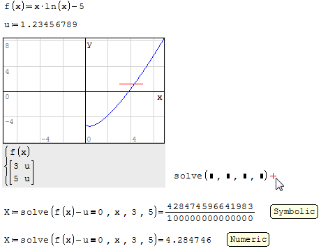

Open a new document to clear previous possible "shadow in context".
solve(2), solve(4) from f(x) menu ... click.

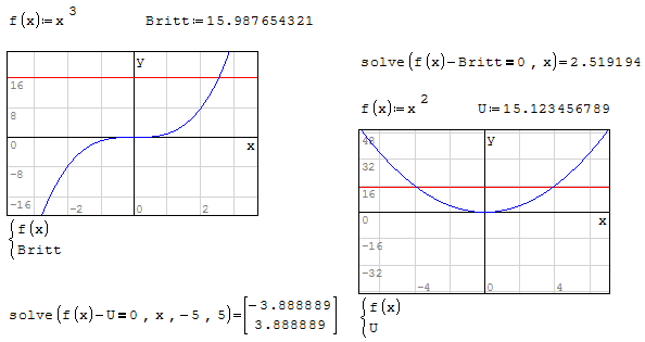

Hi. Isn't "solve(...):=". It is "solve(...)=". Also, if you can't type "solve(x-1,x)=" try "solve(x-1;x)=" Maybe your list separator is ";" instead ",".

solve(2) from the f(x) menu ... just click and fill-in.
Do you have the f(x) in the top menu bar ?
Click f(x) ... scroll down to see solve(2)
If so go by the example ... at least try.

For sure you need that function !
Go again this example.
#11 Опубликовано: 07.05.2019 15:07:58
type
solve left parentheses ...
cursor in parentheses then coma coma coma

I think what Britt1 is trying to ask is about the argument in the solve(2) and solve(4) function. The equal sign "=" inside the argument is a boolean. So, you'll need to use "Ctrl+=" to solve this problem.
I was having some issues in other equations with the same problem, but now it's kind of working. Depends on the equation and mainly the syntax.
