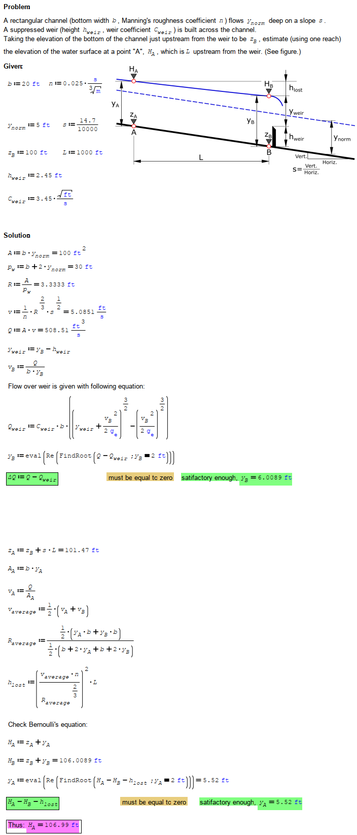

I'm trying to make a SMath worksheet for calculating flow over weir. The problem is iterative, i.e. when you calculate it "by hand" you have to estimate some values and then check if your estimation is close enough.
Here is my workbook:
suppressed_weir.sm (79,98 КиБ) скачан 1211 раз(а).
suppressed_weir.pdf (365,79 КиБ) скачан 815 раз(а).
I tried to solve this problem by using "solve (2)" function, but I'm obviously doing something wrong...
Could anyone help me with this?
Cheers,
Sandro

Solve can't work with units.
Sometimes it just refuses even without units.
Use roots(), FindRoot(), al_nleqsolve() if it fails.
In this order generally.
Regards.
suppressed_weir1.sm (82,41 КиБ) скачан 1214 раз(а).

Thank you, overlord, that works exactly as I wanted!

Jean Giraud, I wasn't precise enough. The problem is regarding the flow over weir, not calculation of a flow rate, per se.
