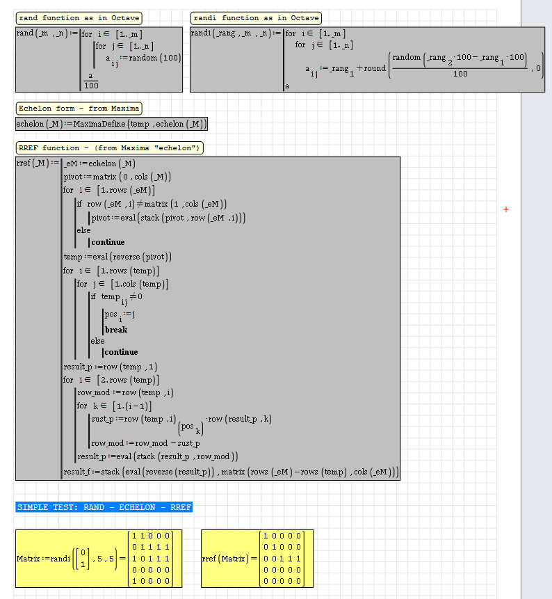

Now problem solved with Maxima plugin...I needed some linear algebra functions such as rref (which is easily programmed after "echelon" function in Maxima).
Thank you anyways for your prompt answer!
Here attached, what I needed:
File:
RREF with Maxima.sm (15,92 КиБ) скачан 1826 раз(а).
OK ... what is the suite of rref ? Solving what ?
Attach a real project, try native Smath first.
I just have some demonstrative Mathcad rref

Hello Jean. In this case it is not a real project. I am preparing a linear algebra ~1-hour course in SMath (usually I show Octave/Scilab). I know that in native SMath I can program the "rref" function myself, but a lin. alg. library such as from Maxima becomes very handy working with vector spaces, orthogonalization, mappings, etc. It can demotivate students to code every function they need.

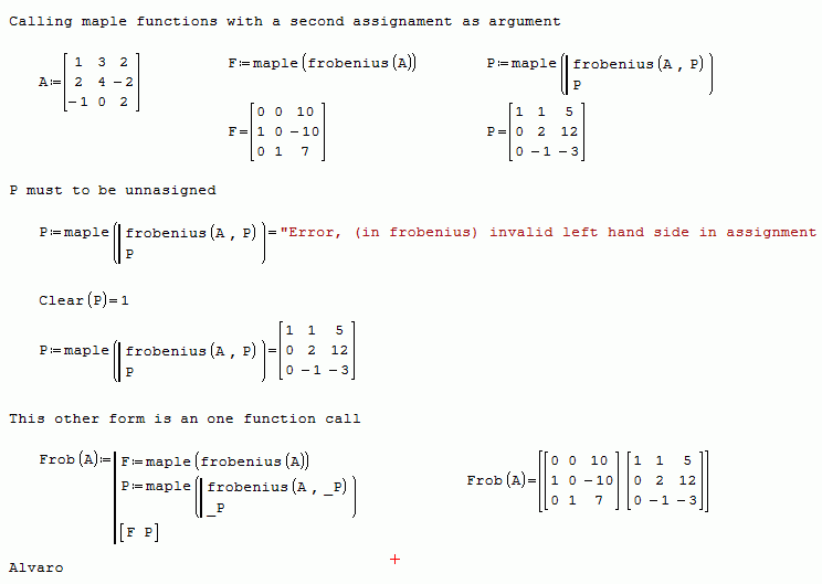

Hola tocayo (I have not idea how to translate "tocayo").
Maybe you can found interesting this post: https://en.smath.com/forum/yaf_postsm35425_Maple-Tools.aspx#post35425
This is the picture in the post:
Maple plugin have full access to the old linalg package, but for functions like jordan and frobenius you must to do some tricks for get the transformation matrix.
