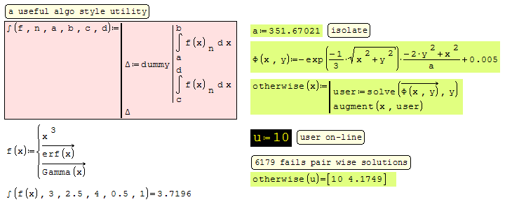

Interesting the implicit/recursive discrete solver.
Few more techniques/tools in these two Smath documents.

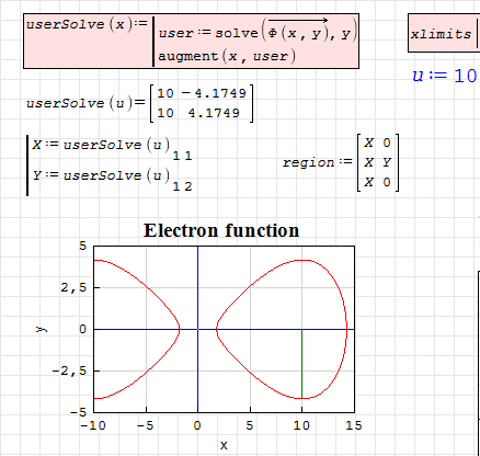

#2 Опубликовано: 28.06.2018 08:42:30
Few more techniques/tools in this Smath document.
... lobes added
Contour SOLVE [user].sm (61,45 КиБ) скачан 1028 раз(а).

#5 Опубликовано: 28.06.2018 14:38:11
Hello Jean,
I just removed at(). Is this all right?

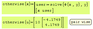

#6 Опубликовано: 28.06.2018 20:23:00
Hello Jean,
For sure, more than correct as your solve(,,) gets pair wise solutions.
Yes, the lobe is symmetric around the 0 datum.

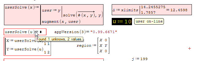

#7 Опубликовано: 28.06.2018 21:08:22
... now I get pair wise solutions. But not augment !
