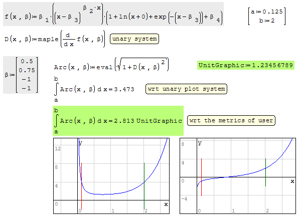

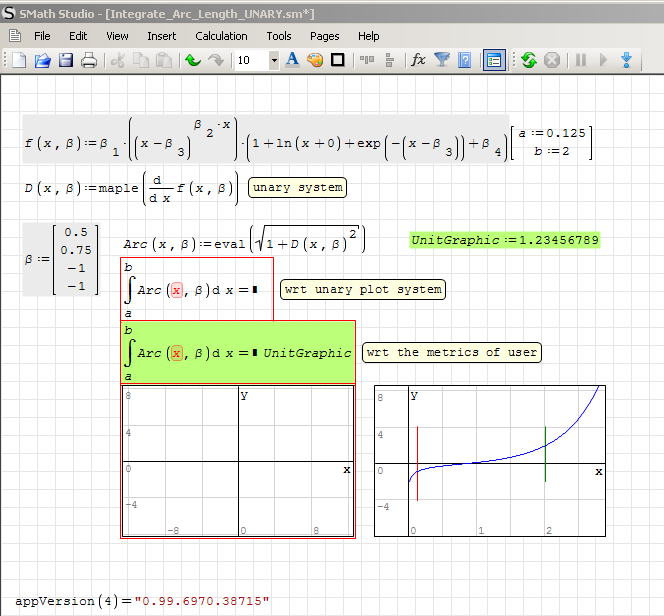

Hi Jean,
in which version did you prepare this example?
I use the last beta version, but I get a error 'x-not defined'
Thank you and best regards,
Andrey
#3 Опубликовано: 03.02.2019 12:25:36
It is probably because MapleTools returns β[#] instead of el(β,#)

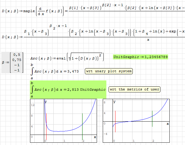

"It is probably because MapleTools returns β[#] instead of el(β,#)"
Thank you, everything works without maple
#5 Опубликовано: 03.02.2019 16:45:38
MapleTools updated. Issue fixed.

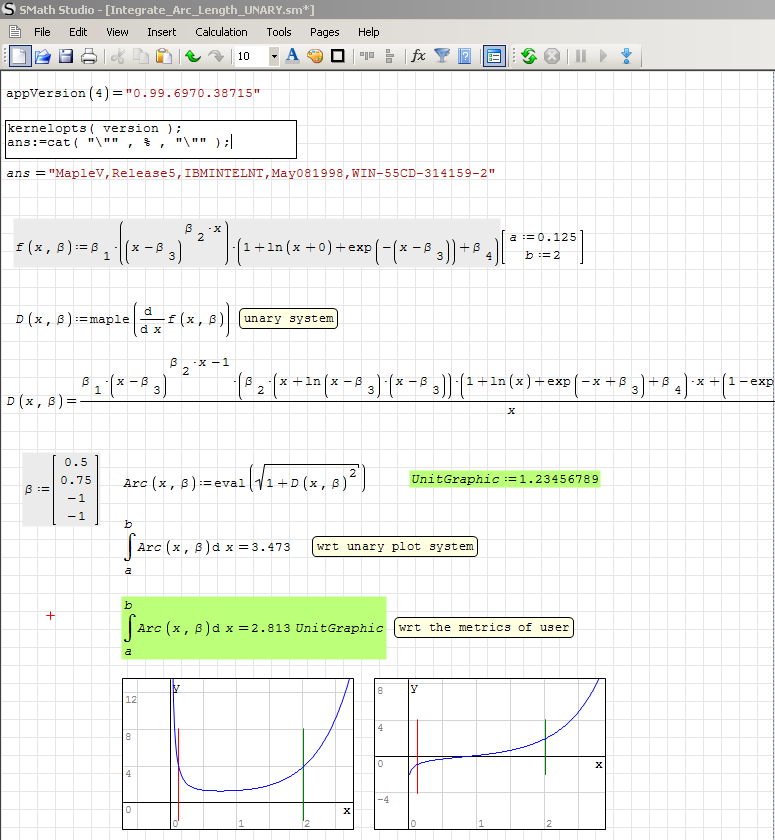

... from Smath 6179.
As Davide points out, your latest freaks Maple !
