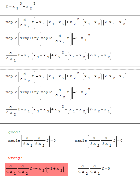

#4 Опубликовано: 08.10.2012 19:26:09
Here some (probably) related issues.
best regards,
w3b5urf3r
#5 Опубликовано: 10.10.2012 16:33:54
Ruben Sidranski
Ruben Sidranski
It's the way SMath handles/prioritizes ASCII characters. I ran into a similar issue with MathCAD. In this case, the second variable of "x" (in the equation) has to be the first variable of the first derivative as shown in w3b5urf3r's screen shot.

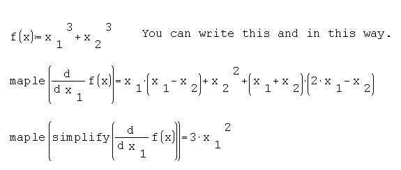

#6 Опубликовано: 03.05.2013 16:11:41
I must be boring with this , but I think there is neither solution nor satisfactory explanation of this "glitch" regarding second derivatives.
Still present in 0.96
#7 Опубликовано: 03.05.2013 16:23:02
#8 Опубликовано: 03.05.2013 16:32:12
Yes, I know. Thank you . I did it on purpose, just to put the stress that maple did it right.
