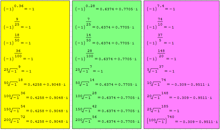

There is a bug I have encountered.
The result shouldn't be -1 or 1.
Result are correct for some not for others.
But we can't know when it is correct or not.

Not limited with exponents.
nthroot() suffers from this bug too.

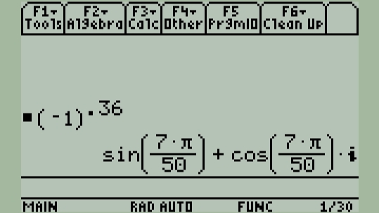

TI-89 Titanium:
Hackmath website:
