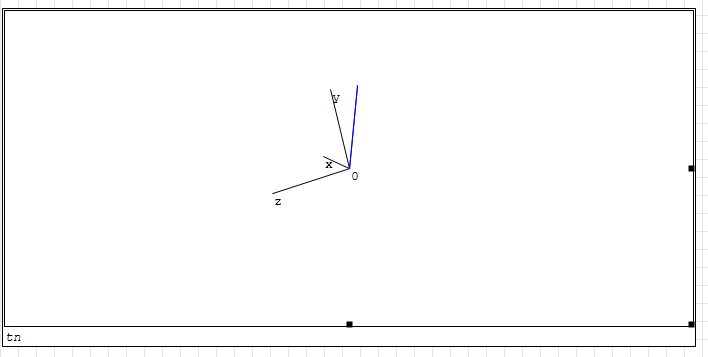

simple stuff like this
results in a weird 3d graph, unless manually refreshed.
I also have to press refresh every time I change anything on the sheet because it goes back to being weird.

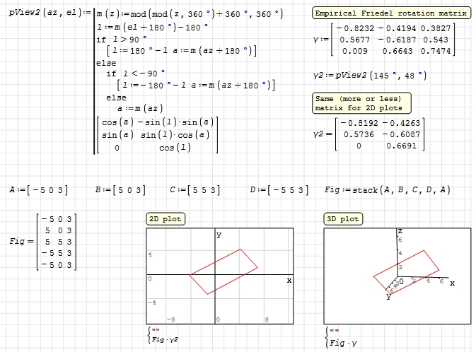

To prevent the 3D graph from changing its perspective, we multiply its matrix by the empirical gamma coefficient.
3d.sm (6,19 КиБ) скачан 1508 раз(а).
what does that even mean? I figured out that the matrix should contain coordinates of the points in its rows, but what's the "empirical gamma coefficient"?
... while remembering Fig*γ is not commutative.

it's buggy though, one would expect graph to not change it's view whenever anything changes, and numbers are disappearing from the axes too, which is super odd.

Fridel gave you the minimalist guidance/model 3 cols + rotation.
The 3D plot has a fixed native orientation,
then rotate manually to better view, then capture as fixed image.

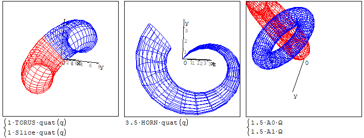

visit more ...
Rotate 3D TREASURY_5 Quaternions MODULO Explorer.sm (71,8 КиБ) скачан 1551 раз(а).

what am I supposed to look for it there ?
1. open 3D, assign plot argument
2. show/hide axes/grid
3. 3.5*HORN*quat(q)...3.5 zoom at will
4. quat(q) the Quaternion rotation system
5. 'q' 1/24 pre-rotation [Quaternion]
5. mesh CreateMesh either/both directions
6. rotate the 3D manually
... look for more.
Rotate Sphere ANIM.sm (25,04 КиБ) скачан 1465 раз(а).

I am not "trying" to create a graph, I know I can plot vectors using matrices by putting points in the rows of a matrix.
I am reporting a buggy behaviour of a 3D graph, whenever contents of the sheet changes, graph's view resets and plot inside of it becomes garbled, until I press refresh, but even then, when I refresh, view resets which is a completely undesireable thing. Not to mention that the axes of the graph are not extending beyond some view-fixed threshold which is annoying (and numbers also disappear from the axes when I make modifications to the sheet). I hope you will finally understand that this isn't an issue with me not understanding how to do X or Y, but a bug report.

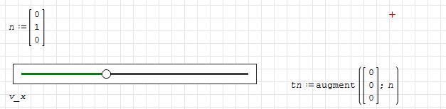

You were talking about 3D plot ... what are you trying to plot ?
Simple: here is the matrix, then the 3D project.
