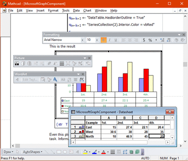

About other graphing options, my opinion is that MSChart component could be very important because they could export to Excel, if not easy, at least you ensure that. I attach my Mathcad 11 mschart component. It is implemented as a general ActiveX component in Mathcad. If you edit it’s code, you can see that the important code is:
ExecuteGlobal str + "End With"

Backing to the mschart, if you now double click on it, you get the Microsoft environment for modify the plot, even it’s not saved you can found the way to get it. Look at the toolbars, are from Microsoft, not Mathcad. At the bottom you have also the sahpes toolbar!

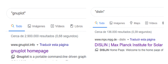

But the biggest problem with dislin is this other:
My recommendation is that if you do that for other software (my recommendation is gnuplot, which was already highly commented on in this forum) you would already have the complete graphics package.
The other option is that instead of integrating a function gnuplot (string, a, b, c, ...) and that has as its starting point gnuplot ("start", "figure_name") the end of the code gnuplot ("end", " figure_name ") and the latter returns in full path to be the argument of the image component, create a text region and follow the same philosophy as the mathcad component scripts.
