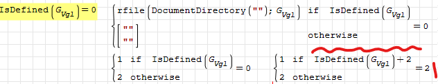

Hi!
I used the red bordered equation (and similar constructions) for a long time.
But this doesn't work no more.

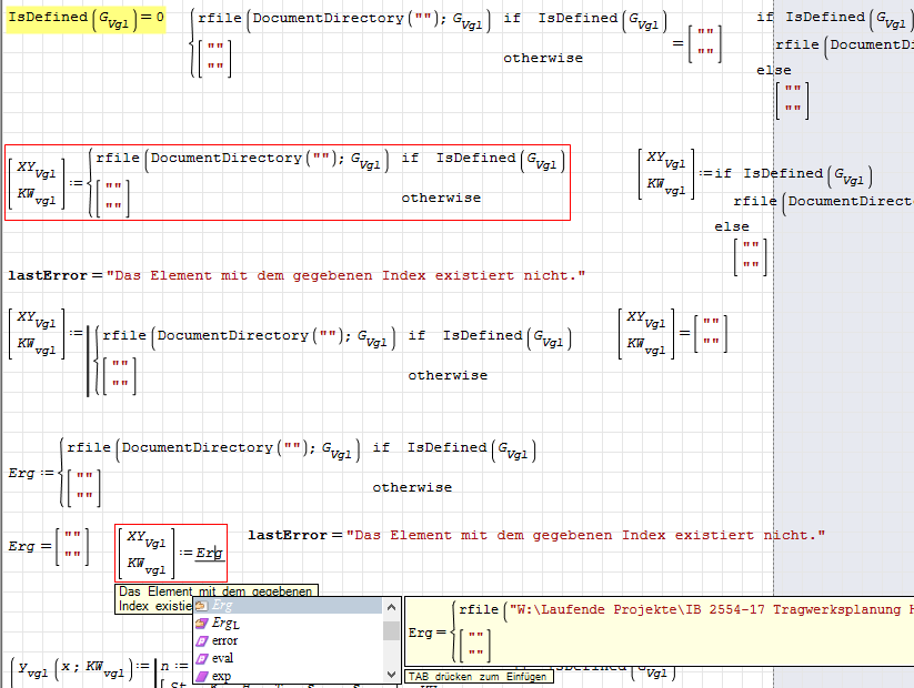

Even if the result of the test is false, the true expression is evaluated, which fails in this example.
If/else does the job.
Assigning the equation to one variable works initially, but on second sight one can see, that the expression isn't really evaluated but only stored.
Is this all the intended behaviour? And why did it change?
Thanks,

Plugin updated, now it should work 1:1 as before (no evaluation is performed on definition).
Please be careful however, since a symbolic evaluation to show the function content or a failed evaluation with an error triggered on the conditions leads to the evalution of all the options.
In general currently is better to use cases to host just dead content (numbers, strings, variables).
