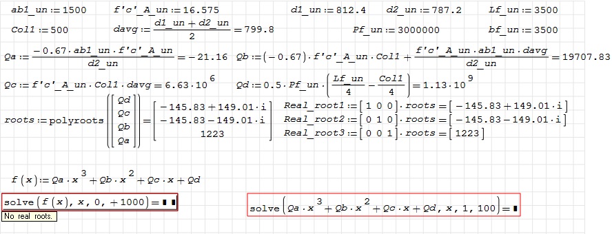

Hi, I have an polynomial equation (x^3 specifically) which I want to get the roots for. The roots are there if I plug in values from WolframAlpha (https://www.wolframalpha.com/input?i2d=true&i=-21.2Power%5Bx%2C3%5D%2B19707.8Power%5Bx%2C2%5D%2B6628342.5x-1125000000), I also checked on excel by changing x=? I found a root of x~128 but SMath won't do it.
On SMath it says no results even after I removed the unit and everything?
I have used 'solve' function, but always get a "no real roots" message (see file attached).
Can someone help out?
Question.sm (14,04 КиБ) скачан 1712 раз(а).
Many thanks in advance!

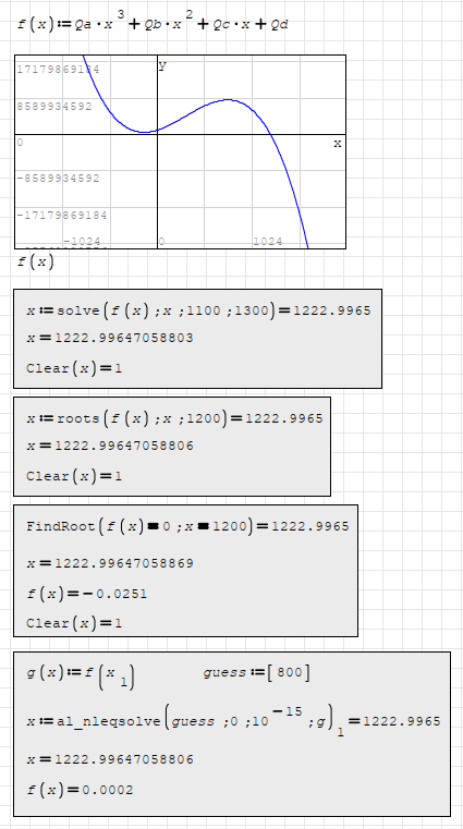

Hi. Try solve(f(x),x,0,1500)=1223.
#3 Опубликовано: 06.07.2022 17:12:34
Try to plot these kind of functions to see what is going on.
Your function is equals to zero around 1200.
Here is your solution with various solvers.
Question_answer.sm (21,25 КиБ) скачан 1699 раз(а).

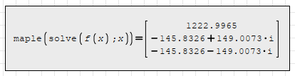

Here is your complete answer by the way.
Good old maple saves the day again.

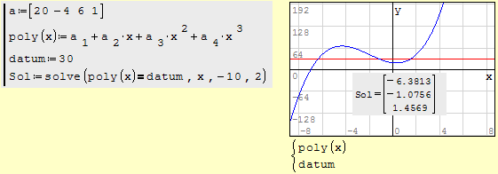

#7 Опубликовано: 07.07.2022 08:38:23
... once your cubic in hand,
you can solve for a specific datum.
Cheers ... Jean.

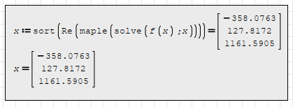

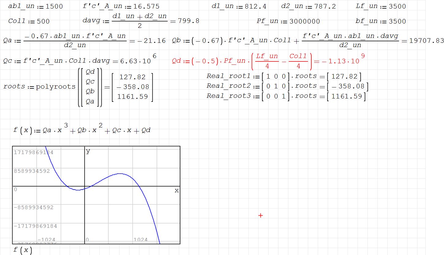

It proved extremely helpful to plot the function where I quickly realized the difference between my SMath and WolframAlpha results. The 4th term 'x4' or 'c' is supposed to be a negative.
I though I was doing something wrong with inputting the data into SMath, but it was the function which I was inputting that was wrong.
In my program by changing "Qd" to a (negative) I got the following roots.
Lesson learned: Quadruple check your functions.
Question_finished.sm (21,5 КиБ) скачан 1683 раз(а).
#9 Опубликовано: 11.07.2022 13:10:43
Good job ! Start be friend with Lagrange canonic.
Question_finished Canonic Lagrange.sm (27,67 КиБ) скачан 1690 раз(а).
#10 Опубликовано: 11.07.2022 13:32:16
... read more in pink.
Cheers ... Jean.
Question_finished Canonic Lagrange.sm (33,2 КиБ) скачан 1703 раз(а).
