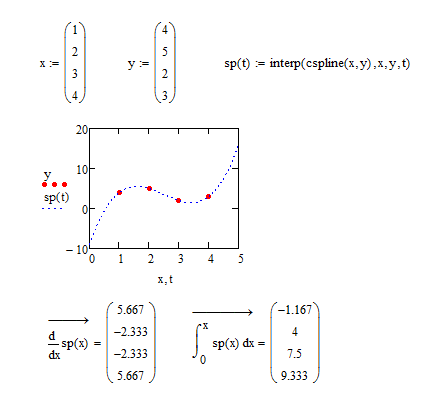

Yes, it is. For this, and for the issues in the extreme of the interpolation intervals and the importance of that in solve differential equations I write this:
Derivative and integral for regular cubic splines.
di cspline test.sm (86,48 КиБ) скачан 1495 раз(а).

Some notes about Radovan's sadness :-(
CinterpQuickDiffInt.sm (30,17 КиБ) скачан 1291 раз(а).

True: Smath "cinterp" is not the best companion and not recognized
vs other CAS. As demonstrated in the attached, not as accurate.
Spline0 l_p_cspline Dspline,Cumul Copy.sm (83,66 КиБ) скачан 1293 раз(а).
