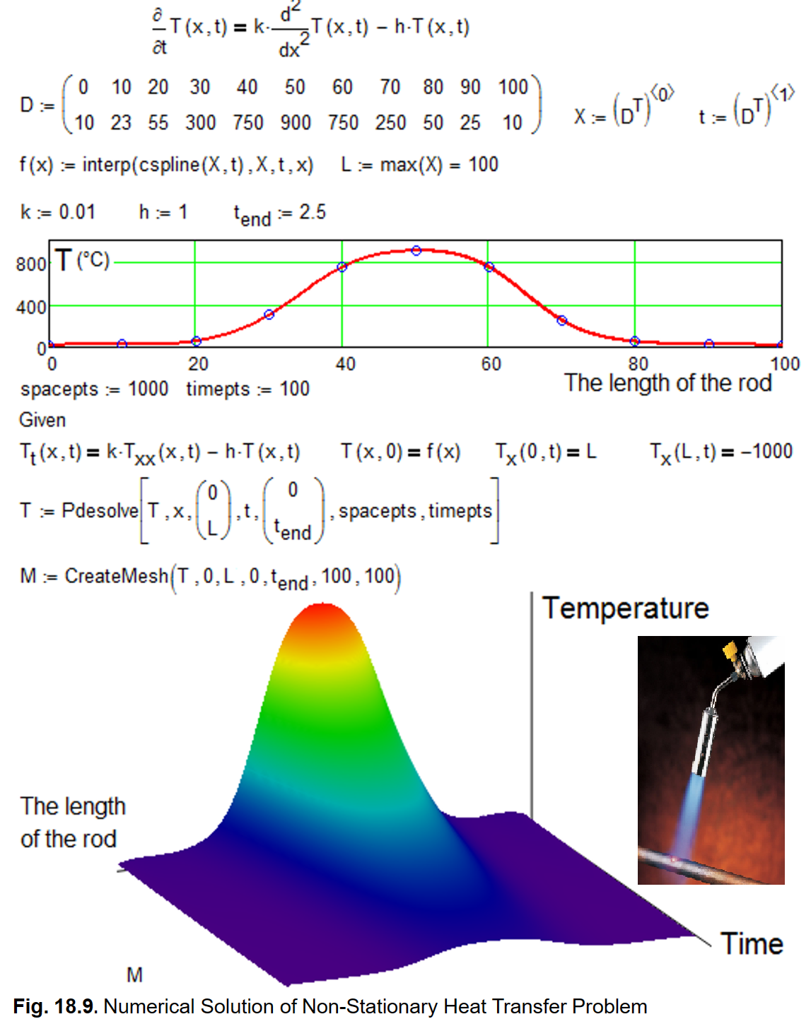

We heated the rod in the flame of a burner.
How will it cool down?
Non-stationary mode!

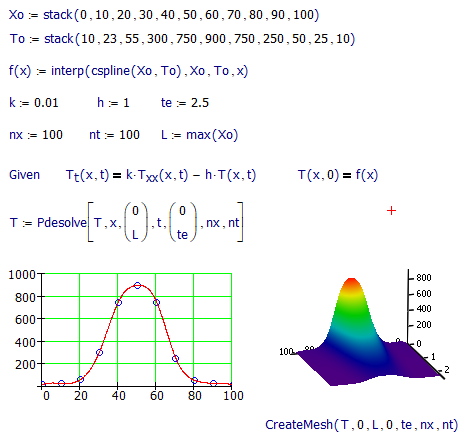

I would like as here
https://en.smath.com/forum/yaf_postst23506_Cannot-plot-T-x--y.aspx
WroteThanks!
Thiele_0 Model QUICK.sm (24,5 КиБ) скачан 1419 раз(а).
Maths EDU [l_p_c_splines TOOLBOX] Copy.sm (584,29 КиБ) скачан 1285 раз(а).
These two documents are SS 6179.
Please, confirm you can open.

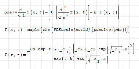

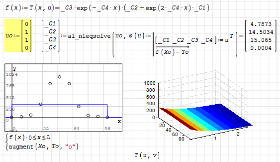

Wrote... And what about the ICs?
We must use one numeric not symbolic method!
Using maple, you can try to use a maple "component" or a maple plot, which gives more flexible access to maple structured functions.
Also, there are some numerical procedures for pde's in Maxima.
Notice that in Mathcad the border conditions for δT(x,t)/δx are not considered for obtain the solution.
With SMath, you can try to adjust the curve choosing good guess values in the yellow vector.
pdesol_num.sm (14,78 КиБ) скачан 1387 раз(а).
