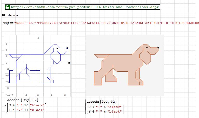

Yes, you explained it to me with a couple of examples a few days ago, and I still don't use it. Maybe you could use base 52, with A,B,C,... = 0,1,2,... and a,b,c,... = -1,-2,-3,... Also separate with optional spaces and truncate the coordinates to facilitate the encoding of simple drawings that you have that are not integer coordinates, among some scale function than can be applied too. Visually it could look better: lowercase coords are negative and uppercase are positive, and the lexicographical order gives an idea of the length.
d2d-paper-airplane-code52.sm (14,76 КиБ) скачан 1797 раз(а).

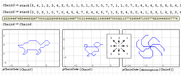

Hi Viacheslav. Another code: Freeman Chain Code of Eight Directions.
Chain Code.sm (17,74 КиБ) скачан 1831 раз(а).
