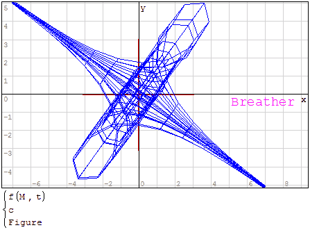

Thanks Ber7 for your repost/new animations. Some don't work in Smath 5346,
so what. Animation is a very nice feature from Smath.
Rotate XY.sm (474 КиБ) скачан 1672 раз(а).
