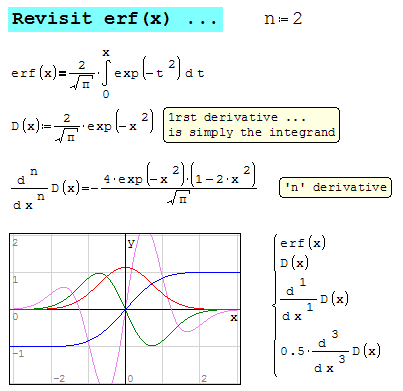

#2 Опубликовано: 09.01.2023 11:19:36
Is it possible to add more pleasing higher order derivative, like these ?
More Derivatives is limited by the symbolic of f(x)
More pleasant ... from invention.

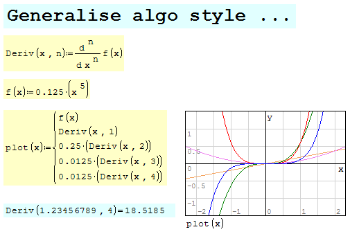

#3 Опубликовано: 09.01.2023 12:37:18
...make it algo style for in-situ command line.
#4 Опубликовано: 09.01.2023 13:19:06
Maths Derivative GENERALISED algo.sm (9,37 КиБ) скачан 1698 раз(а).

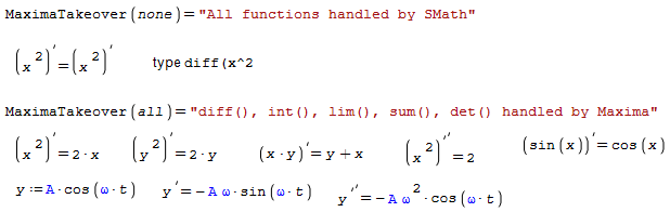

#5 Опубликовано: 09.01.2023 15:02:06
SMath has a built-in prime operator ()'. It can be created but will not be evaluated in the base configuration of SMath Studio
The Maxima plugin links this operator to the function Diff(1), which computes the total derivative of an expression with respect to all variables in that expression. You can mark symbolic constants in the expression by making them custom units (writing them with a leading prime like 'y).
The function Diff(1) is always avaliable if the Maxima plugin is installed, yet the operator form must explicitly be "hijacked" by the command MaximaTakeover().
It is then available as diff(1) in the dynamic assistant.
You can create second derivatives using nested ()' operators but that doesn't look good. Perhaps appropriate operators could be defined in the custom glyphs plugin.
diff1.sm (8,03 КиБ) скачан 1777 раз(а).

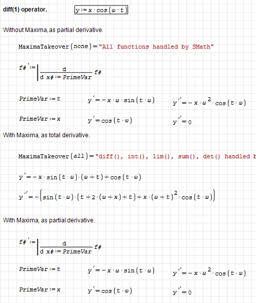

#6 Опубликовано: 09.01.2023 18:56:03
Hi. Some notes.
SMath has a built-in prime operator ()'. It can be created but will not be evaluated in the base configuration of SMath Studio ...
You can assign it to a partial derivative like operator inside SMath. (First example in the image)
... The Maxima plugin links this operator to the function Diff(1), which computes the total derivative of an expression with respect to all variables in that expression. You can mark symbolic constants in the expression by making them custom units (writing them with a leading prime like 'y).
Maxima is a great plugin. You can have it and prime as partial derivative, this is, it is not necessary to use units to mark variables other than the variable of the derivative. (Last example in the image)
diff1.sm (20,62 КиБ) скачан 1774 раз(а).

#10 Опубликовано: 09.01.2023 23:07:00
Maths Derivative GENERALISED algo.sm (9,37 КиБ) скачан 1718 раз(а).
