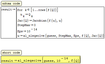

#2 Опубликовано: 14.04.2022 09:40:58
Fridel Selitsky
Fridel Selitsky
Hello,ndtma
Fragments withal_nleqsolve() can be reduced to one line.
alnlegsolve(3).sm (635,89 КиБ) скачан 1591 раз(а).
NDTM Amarasekera 14.04.2022 10:06:00
#3 Опубликовано: 14.04.2022 10:03:58
NDTM Amarasekera
NDTM Amarasekera
Hello,ndtma
Fragments withal_nleqsolve()can be reduced to one line.
Hello Ber7,
Thank you very much for your very valuable suggestion.
It works fine.

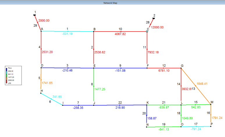

Hello Nugegodage
I hope that you and your family are very well in these times of crisis in your country.
I have made your example in the Epanet program, the results are shown in the graph below.
For the network to be valid, Node A must have an input pressure equal to or greater than 129.4 mH2O,
and Node C equal to or greater than 150.28 mH2O.
Carlos

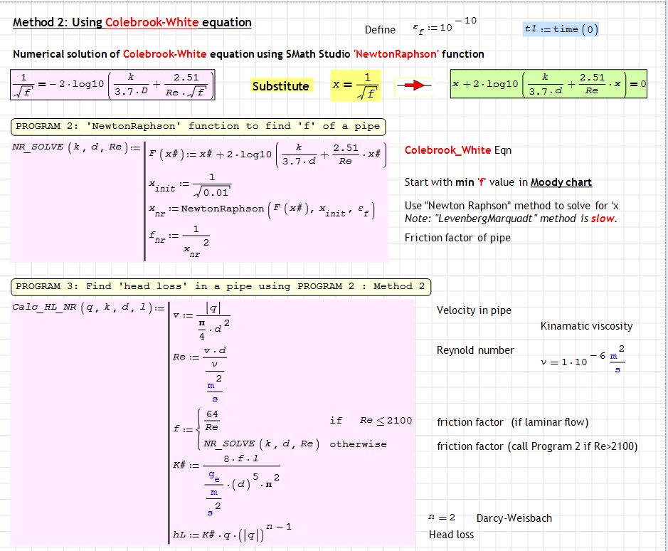

#9 Опубликовано: 26.05.2022 04:38:30
NDTM Amarasekera
NDTM Amarasekera
The subject revisited.
In my original post #1, the K values were simply computed using a given formula,
and head loss in each pipe computed accordingly.
In Method 1 of the attached example, friction factors (f) depend on the Reynold numbers (Re)
of each pipe and computed using a given formula involving Re.
In Method 2, NewtonRapson function of SMath is used for the numerical solution of the
implicit Colebrook-White equation to find f.
Many thanks to Ber7, Alvaro and Carlos for your earlier suggestions on the subject.

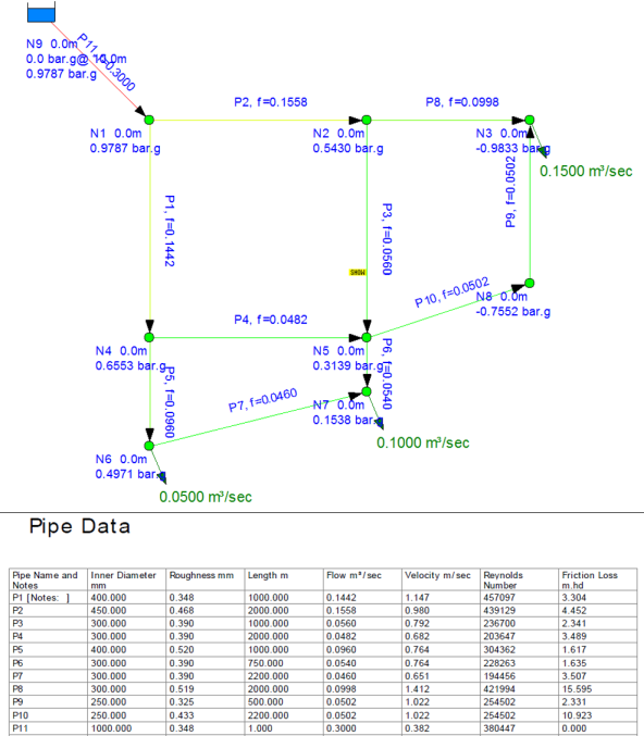

#10 Опубликовано: 29.05.2022 23:06:37
CBG
CBG
Hello ndtmda
Here are the results of your example calculated
with a very old version of Pipe Flow Expert.
Carlos
#11 Опубликовано: 30.05.2022 05:19:26
NDTM Amarasekera
NDTM Amarasekera
Hello ndtmda
Thank you Carlos!

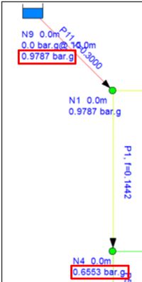

#12 Опубликовано: 06.06.2022 03:23:10
NDTM Amarasekera
NDTM Amarasekera
Hello Carlos
Can you please explain how the marked values of gauge pressures are calculated?
Thank you.
#13 Опубликовано: 06.06.2022 23:31:51
CBG
CBG
Hello Ndtma
Hello Carlos
Thank you.
This pressure (0.9787 bar g) is caused by the water level in the tank, which is 10 meters.
The pressure of 0.6553 bar g is obtained by subtracting from the inlet pressure
of 0.9787 bar g. the losses in the pipe of 0.3234 bar g (3.304 m hd)
The system is not correctly resolved for the pressures, since nodes 3 and 8 have
pressures below atmospheric.
Carlos

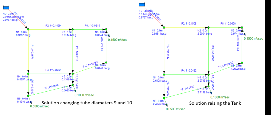

#15 Опубликовано: 07.06.2022 17:20:35
CBG
CBG
Hello Ndtma
Thank you Carlos.
You're welcome.
Changing the diameter of tubes 9 and 10 from 0.25 m diameter to 0.5 m, the problem of negative pressures is solved.
Another way to solve it is by increasing the level below the tank from 0m to 20m. and with the liquid level at 10 m
Carlos
NDTM Amarasekera 07.06.2022 22:55:00
#16 Опубликовано: 07.06.2022 22:55:01
NDTM Amarasekera
NDTM Amarasekera
You're welcome.
Thank you Carlos. Your contributions are very much appreciated.

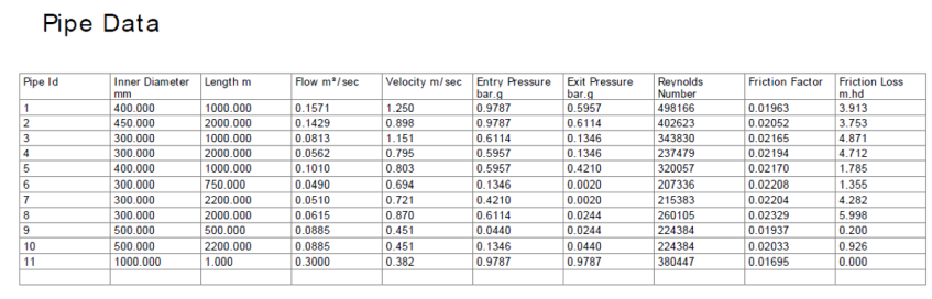

Hello Carlos,
Can you please post the Pipe Data Table (with Pipe Number, Inner diameter, ..... Re, Friction Head loss)
for the case Changing the diameter of tubes 9 and 10 from 0.25 m diameter to 0.5 m..
as I get different results for this case.
Hope I am not troubling you.
#18 Опубликовано: 11.06.2022 16:19:34
CBG
CBG
Hello Ndtma
Hello Carlos,
There is no problem.
Here is the requested table
Carlos
