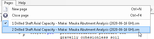

I recently saved an sm file overnight and when I opened this morning the changes I made were gone! The time stamp on the file is correct (~1 AM) but none of the changes I made between 5 PM and 1 AM are shown. I finished with over 30 pages but now the file is down to 18.

WroteI am new to this program and using the most recent version.
Unlikely it has to do with the SS version. Rather the Win.
"Save" may save anywhere for several times... then where ?
"Save as" saves where you address, as you have it on screen.
Your document did not evaporate by itself.
WroteVery strange... It is possible that you had the same file opened twice in the same instance?
That is the right answer, common mishandling.
Thank you both for your help! I will not make this mistake again
