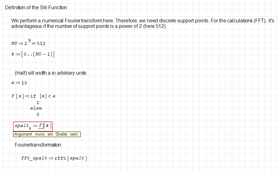

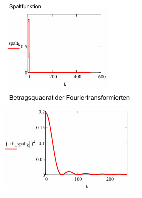

I have a Mathcad Document about Fourier transform that I want to translate into SMath.
I already dowloaded the FFTPack plugin. I used the same functions from the Mathcad document which doesn't work in SMath.
I tried a bit but nothing is working. The error message says "The argument must be a scalar."
I attached screenshots from my SMath document and the original Mathcad document.
Does anyone have an idea or a helpful tip?

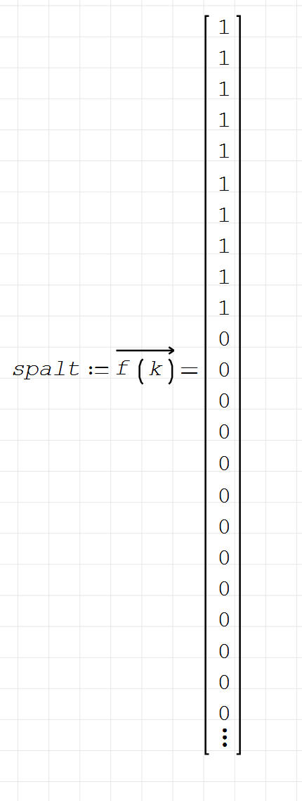

#3 Опубликовано: 14.05.2026 18:55:58
try to construct the vector like this

Thank you! That worked and the error message is gone.
I'm still having trouble plotting the graph. The graph is not being displayed but there isn't any error message.
Did I overlook something? Does the rfft() function work different in SMath than in Mathcad?

Check if it can help you. The graph has the correct shape but the values are different.fft_spalt_test(sergio).sm (10,62 КиБ) скачан 513 раз(а).

Thank you Sergio!
I'm going to try around with your file a bit more. But having the correct shape is already very helpful and good enough.
