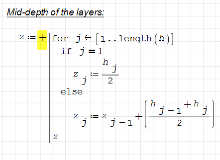

Hi all, I am putting together a quick worksheet to calculate factor of safety against soil liquefaction triggering. As I have been going step-by-step and defining the various variables, I noticed that all the calculations take place more or less instantaneously, whereas the last variable I defined (N1_60cs) seems to take a relatively long time to calculate (approximately 12 seconds on my machine). The worksheet I have so far is attached.
Any thoughts as to what is causing this? Thanks in advance!

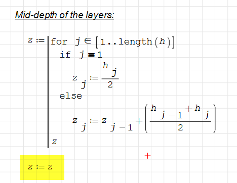

#2 Опубликовано: 20.12.2023 00:50:59
select all > optimization > numeric
AND EITHER
z:z
OR
z:+line(...)
This is because z:line() is a procedure (something like a function, but for variables); it doesn't evaluates in place on definition, hence is completely calculated from scratch every time you need z, z[j], etc....
Using a + between the definition operator and the line() function, you don't have anymore a procedure; using z:z, it evaluates once from that point onwards.
Seismic Site Class & Liquefaction Potential_num.sm (124,85 КиБ) скачан 1489 раз(а).

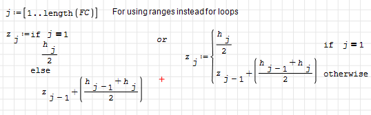

#9 Опубликовано: 20.12.2023 12:07:29
I like having the lines because it makes it clearer as to which parameter I am defining.
Hi. You can eliminate all the for loops using the SMath index vectorization, which work more or less like the same concept in matlab, with cases() for having some visual separation
Seismic Site Class & Liquefaction Potential v2.sm (119,62 КиБ) скачан 1547 раз(а).
