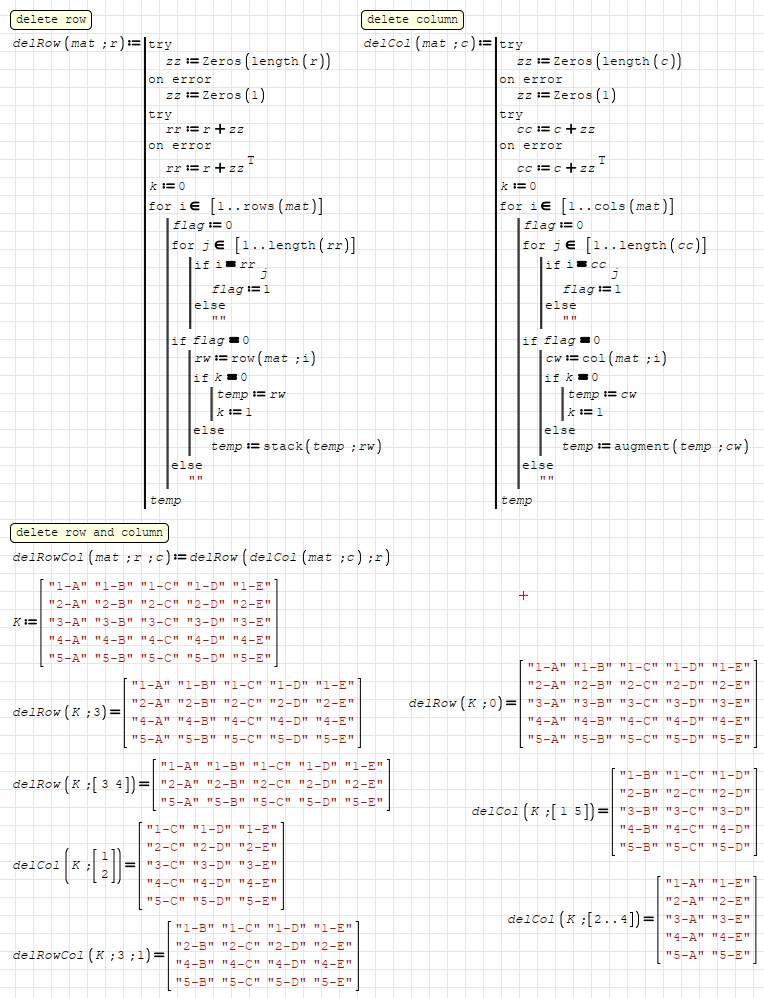

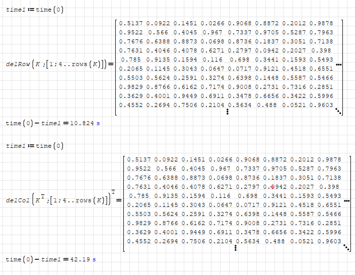

Some functions for row and column deletion.
For row and column functions accepts horizontal and vertical vectors, range(2) and range(3), numbers.
No need to convert anything during input, and exceeding and subceeding values not be removed.
delete_rowcol.sm (21,39 КиБ) скачан 1177 раз(а). (old method)
delete_rowcol.sm (15,58 КиБ) скачан 1193 раз(а). (new and faster method)

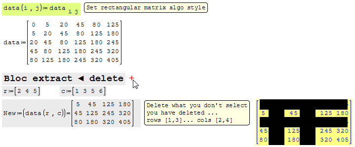

Otherwise useful ... you delete what you don't select.
sergio 31.05.2021 08:16:00

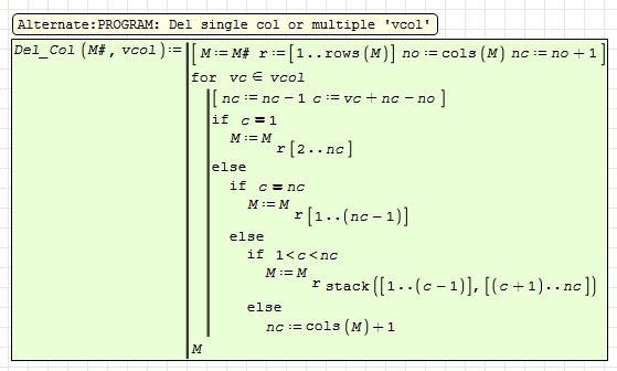

Alternate program. Very fast on large matrix.
Jean's program very helpful. Thank you Jean
New_Matrix_Delete [col_row].sm (24,06 КиБ) скачан 1093 раз(а).

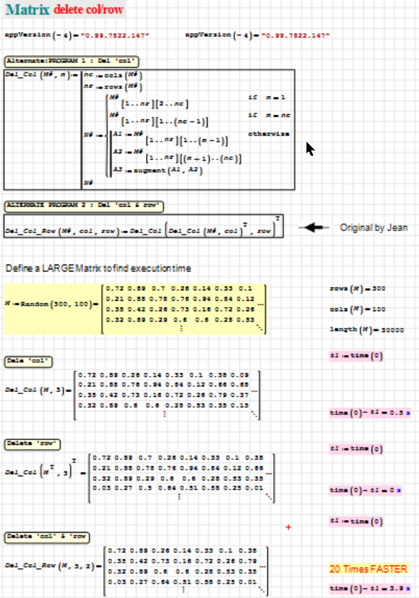

#4 Опубликовано: 01.06.2021 11:30:22
598 сообщений из 1 379 понравились пользователям.
I tried your solution and found out it is faster with single row or single column removal. Good job.
And also found out transpose method is way much slower if I use ranges or matrices for input.
That method is not fast enough and not a good method when you use vectors of columns or rows for removal.
So I have combined your solution with mine, a fast and feature-full method is born.
New file is added in first post.

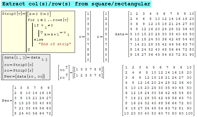

#5 Опубликовано: 01.06.2021 12:52:21
From square/rectangular matrix algo style do all at will.
1. delete cols & rows in any shuffled ways.
2. conserve selected rows deleted of 'j'.
3. conserve selected cols deleted of 'j'.
Hopefully, no red in your SS version !
Thanks, be good ... Jean.
Utilities Matrix Minor [col_row] ADVANCED OTHERWISE Copy.sm (21,58 КиБ) скачан 1087 раз(а).
#6 Опубликовано: 01.06.2021 13:28:36
NDTM Amarasekera
NDTM Amarasekera
Yes it works fast. It is a smart code with added features.
Thank you.
overlord 03.06.2021 21:45:00

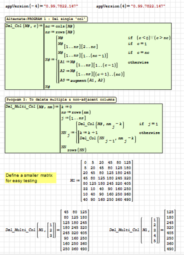

#7 Опубликовано: 02.06.2021 15:34:35
NDTM Amarasekera
NDTM Amarasekera
A revised version, to delete multiple non-adjacent columns.
Faster on large matrix than my last example in post #3.
New_Matrix_Delete [col_row]_R2.sm (41,9 КиБ) скачан 1055 раз(а).
overlord 03.06.2021 21:45:00, Alvaro 02.06.2021 17:53:00
#8 Опубликовано: 02.06.2021 18:12:03
1 118 сообщений из 1 794 понравились пользователям.
Hi Amarasekera. Please try this other version, which works for single column values or column ranges.
New_Matrix_Delete [col_row]_R2.sm (38,79 КиБ) скачан 1041 раз(а).
overlord 03.06.2021 21:45:00, NDTM Amarasekera 02.06.2021 23:47:00
#9 Опубликовано: 02.06.2021 18:35:44
Utilities Matrix Minor [col_row] ADVANCED OTHERWISE Copy.sm (97,77 КиБ) скачан 1121 раз(а).
NDTM Amarasekera 02.06.2021 23:48:00
