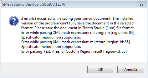

I am having trouble converting the following "sampleXMCD.xmcd" file to SMath Studio. I foresee that in the future I will HAVE TO convert some of the v15 .xmcd files to SMath and I would love for the conversion to be done automatically.
Any ideas? This will greatly help me at work.
Thanks!
sampleXMCD.xmcd (41,73 КиБ) скачан 1522 раз(а).

The patch on the UnitOperator seems that helps even here: http://en.smath.info/forum/yaf_postsm33083_Mathcad-file-import.aspx#post33083 (still missing the conversion for the "plot" region)
Reported as SS-2341

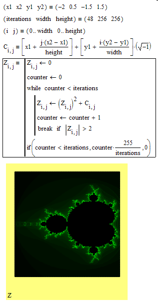

The attached image is Mathcad 11. Should be same in Mathcad 15, easy for 15 users.
Once in Mathcad 15 by some Smath users, then attempt to "convert" Smath.
In Mathcad 11: independent of ORIGIN 0 or 1. The plot is matrix in any color, in Smath
it will be grayscale unless Alex can make it RGB.
Something simple to crunch for you collabs asking for Mathcad 15 => Smath conversion.
Hope to read feedback ... Jean

edit: Screenshot of the error message
please don't delete any post if it contains bug infos
