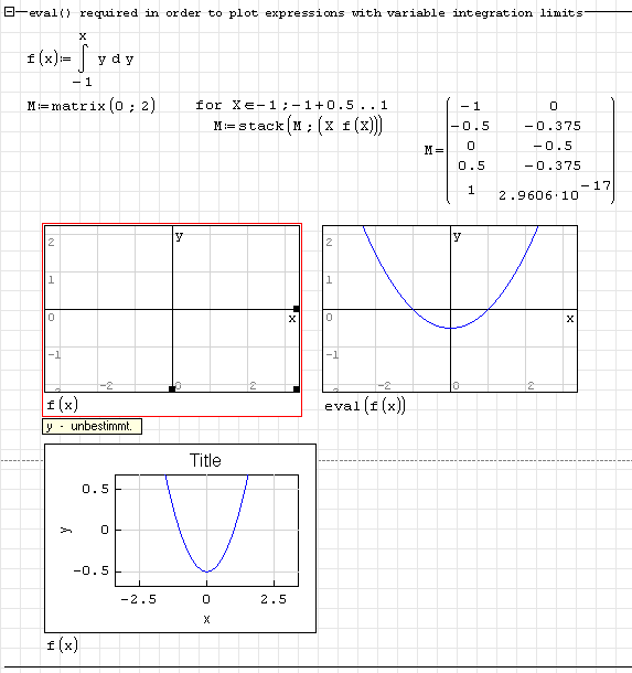

#20 Опубликовано: 26.07.2013 06:17:28
There still (as of 0.96.4909) seems to be a problem to plot functions involving definite integrals. You have to embed them into eval(), otherwise they give a useless error message (claiming that the integration variable is not defined)
The X-Y Plot plugin does not seem to have that problem. A workaround might be to apply eval() for expressions to be plot
by default. At least I am not aware of counter-indications.
