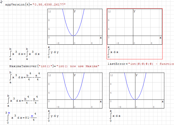

I am trying to solve the problem that I can't overwrite special functions in the Maxima plugin via the IPluginLowLevelEvaluation.ExpressionEvaluation interface, see SS-2401.
Obviously one can add definitions to the canvas from within a plugin function execution using something like this:
This replaces the built-in definition of int(4) with the one provided by the maxima plugin in the current downstream canvas.
The above solution was found by blindly poking around, assisted by the Core doc.

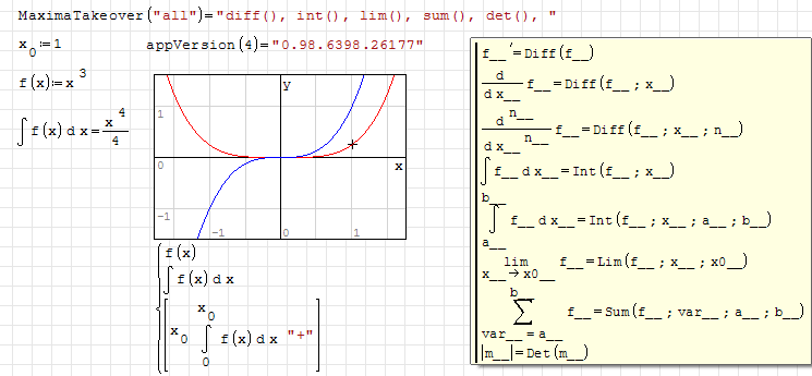

I implemented a new MaximaTakeover() function, which adds definitions to the context or removes them according to the given arguments. First tests seem very promising, such that the full functionality of the Maxima plugin can be re-established soon.
It turned out that something like
didn't do the job of deleting the definitions from the global context. The deletion actually worked (as per inspection in the debugger) but that was of only local scope. I had to resort to Clear().
int index;
if (context.Contains(lhs, out index) context.RemoveAt(index);

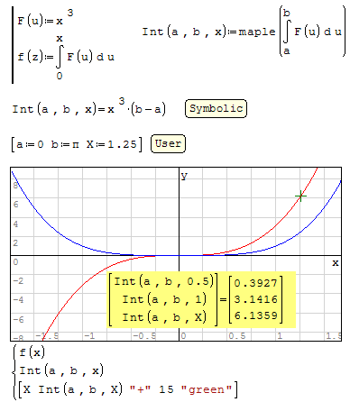

Hello Martin,
Interesting, though the algo style is native in Smath 5346, 6179
except the first release 6179 is missing Int(2) [indefinite].
I think Sum will work as well, at least it was 5346.
Cheers, Jean

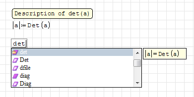

I'd like to provide a standard description to the definitions created in MaximaTakeover().
Currently, the descriptions simply show the definition (as can be seen in the previous post).
The idea is, to get the description of the Maxima function (Int(...) and add it as description to the generated definitions, perhaps with some adjustments (convert uppercase to lowercase in function names).
How would I do that?

You can use the AddDefinition(Definition value) method; Definition has some constructor with the description argument
Martin Kraska 01.08.2017 19:01:00
WroteYou can use the AddDefinition(Definition value) method; Definition has some constructor with the description argument
Thanks. Davide.

This approach didn't work either, I even could not see the descriptions being generated at all in the debugger.
And in the end, when trying to provide a description in a math region directly, this is ignored. For the moment I have to give up. This might be related to the target functions being special functions. Re-definition somehow slips through, re-description obviously not.
![2017-08-02 00_50_20-SMath Studio 0.98.6398 - [Takeovertest1.sm_].png](/ru-RU/files/Download/24KbNC/2017-08-02-00_50_20-SMath-Studio-0.98.6398---[Takeovertest1.sm_].png)
Hello Martin,
Confirmed. I've looked at the core code and I know why, I'll try to make ii possible.
WroteThis approach didn't work either, I even could not see the descriptions being generated at all in the debugger.
