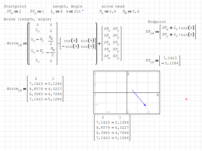

Dear experts,
Sorry if this question is stupid, but I am new to SMATH.
In order to plot some simple vector diagrams (using the SMATH built in diagram) I did the following.
I want to plot the vector from a given start point with given length and angle.
So for the arrow I created a polygon, rotaded and moved it. This works quite well. I als can put the formulars into the plotting input area.
But it would be nicer to define a function e.g. Arrow(start_x; start_y; length; angle).
Is this possible? What would be the syntax?
Is there maybe a smarter way of doing this?
Thanks in advance!
Ralf
arrow1.sm (11,18 КиБ) скачан 1164 раз(а).

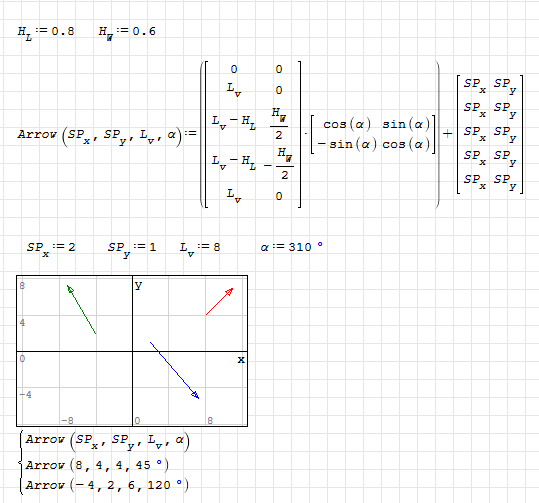

Hello Ralf,
welcome in the community
Simply put a function name on the LHS (left hand side) of the assignment operator
![2018-03-24 16_56_50-SMath Studio - [arrow1.sm_].png](/ru-RU/files/Download/MgCoWa/2018-03-24-16_56_50-SMath-Studio---[arrow1.sm_].png)
arrow1 (r1).sm (12,64 КиБ) скачан 1160 раз(а).
Once you have done it if you want to rename a variable inside the function you can do it at once using the F8 key when the text cursor is inside the variable you want to rename.

WroteI want to plot the vector from a given start point with given length and angle.
Gorgeous application of the 2D rotation matrix.
Few more in there.
Circle_rkfixed Arrow.sm (27,63 КиБ) скачан 1190 раз(а).
